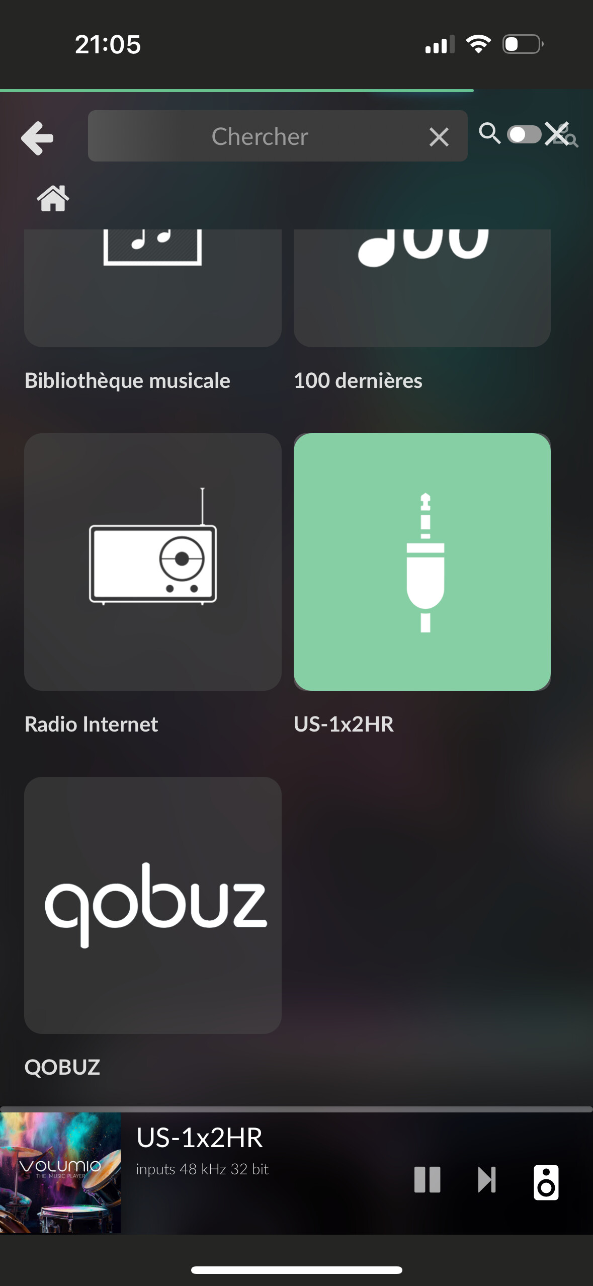

Connect your usb ADC to your RPi and boot Volumio. If you are a premium user, you should see your ADC interface appearing as a new tile in the base menu (US1x2H in my exemple). Click on this tile to activate this input then play whatever is connected to your ADC, it will go through Volumio.
Benoit, Yes I have the premium level. I did with an USB adc/DAC converter (U-PHORIA UMC202HD from behringer) I bought years ago with a microphone for measurement.
This box is immediately recognize by volumio and works.
