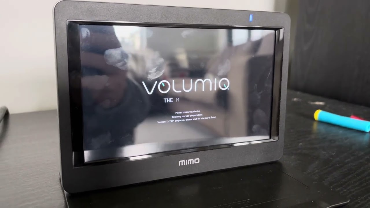

USB DisplayLink monitor support
Running v3.799 x86

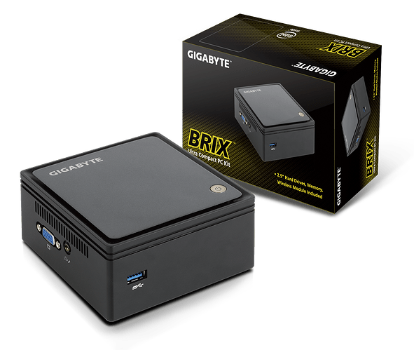

Computer gigabyte bxbt 2807
monitor is a mimo 760r
Logs http://logs.volumio.org/volumio/2vGdVwp.html
sudo lshw sudo lshw - Pastebin.com
Video of screen turning on showin startup graphics then switching to the tty login
If i change the output over hdmi i can get the screen to blank and unblank, but its like volumio isn’t sending the video to the correct screen
xrandr gives a no output error
I’m unsure what to look at

Thank you very much. I did seem strange that it worked for graphics and then stopped. But that all makes sense. Again thank you very much. I’ll stick with the option to accept it won’t work until 4.x comes along for me. I guess that begs the question when might it be available - months? Years? Either way i’ll patiently wait. Again thank you for the in depth explanation - hopefully other poeple will see this from searches too
