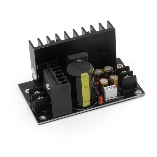

Power supply specs:
- LT1083CP linear voltage stabilizer
- Input voltage: AC from 0 to 34 V
- Output voltage: DC from 1.25 to 48 V (adjustable)
- Maximum output current: 10 A
- 4 rectifier diodes (Greatz bridge)
- ARK screw connector
- LED indicating power supply
- Dimensions: 80 x 53 mm
