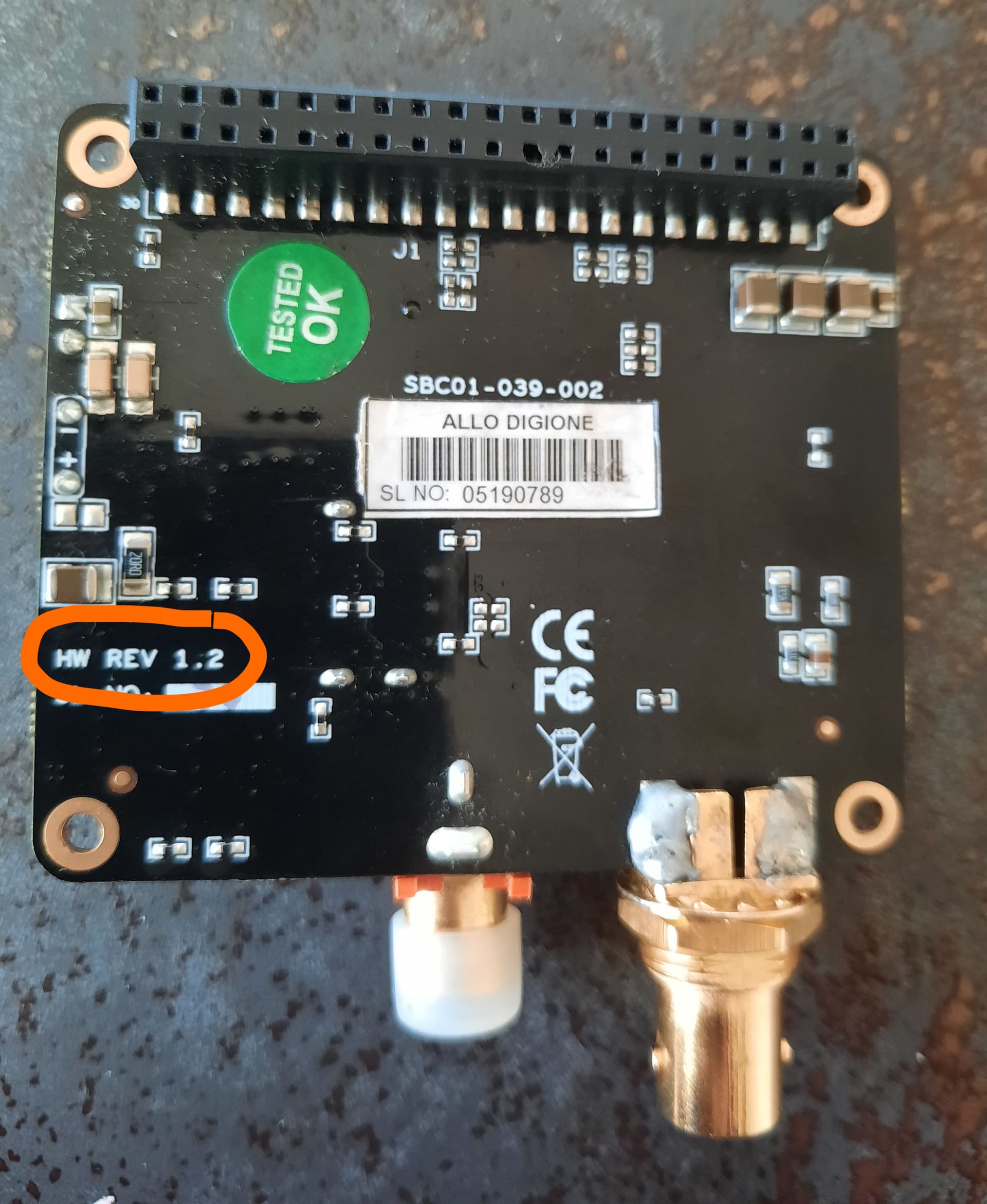

Hello @Ema82 ,
Could you give us some feedback?
  1. Did your ‘Allo Digione’ card work perfectly with your Raspberry Pi 5? Do you think it would work with the various Raspberry Pi 4 models?
  2. Can you tell me if your Digione is a ‘Hardware Revision 1.2’ or 1.3? It says ‘HW Rev 1.2 or 1.3’ at the bottom of the card.
    Allo Digione HW Rev 1.2 | Allo Digione HW Rev 1.2 | Flickr
I ask because I’m concerned that ‘Hardware Revision 1.2’ is only compatible with the RPi3, while ‘Hardware Revision 1.3’ is compatible with the RPi4 and above.
:arrow_right: If you could confirm that HW Rev 1.2 works with the Raspberry Pi 5, that would be great.
