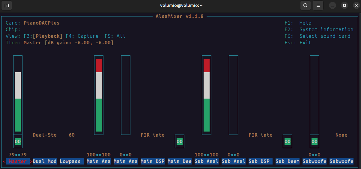

Putting some updates there:
  1. Alsamixer picture provided
  2. In Dual-Stereo mode, only 1 set of RCA is working, even if i put some “volume/gain” on the “Main Ana” channel & “Sub Ana” channel located on the right side of the other “Main Ana” and “Main Dee”. The “volume/gain” is either 0 or +0.8dB
  3. In Dual Mono mode, it seems only 1 RCA output is working (not 1 set of RCA, only 1 out of the 4 present on the board)
Don’t know if useful to anybody. I can try things if somebody wants.
Have a nice day

Hi
Thanks for your suggestion.
Sadly, it didn’t worked. I did the workflow suggested by @nerd twice. Only 1 set of RCA output working in Dual Stereo mode
Tested audio and checked with alsamixer.
I know that after the upgrade to 3.807, i had to reset the sampling to 32bits (known bug for Allo Piano to play mp3). It didn’t happened in a long time, so my system’s upgrade did more than the usual.
If you think i should try to do a proper brand new imaging of the latest Volumio image for a “brand new” install, tell me.
I could try in a few days.
Have a nice day

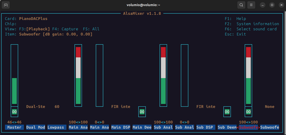

Hi
Full Re-image restored Volumio+Kali+Piano2.1 to its expected state!
Current using Dual Stereo (to use 1 amp or the other…) like i used to.
Alsamixer screenshot attached
Thanks for mentionning that you (@nerd & @Josh2000 ) had the same setup.
[almost no other DAC has dual outputs like this without going through too much trouble…hence me keeping the Piano as long as possible…]
Have a nice day and thanks again!
