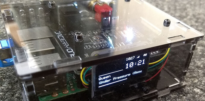

see here two easy build volumio devices with oled.
  1. DACberry one+ , with smoked one+ case and 1.3 OLED from OSA
    (also for DACberry pro+ avaible)
    for OLED I use that one: github.com/antiprism/vol_oled.
    very beautiful black/white display!
  2. IQaudio DAC PRO with XLR board and CASE( all from IQaudio), & Nanomesher Hackable Pi Switch Cap.
    This nice solution includes an IR and remote control and fits into the case.
    just install nanomesher plugin! ready.
