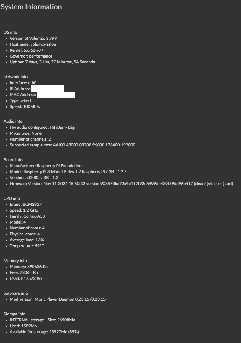

Can you install the plugin System info and see what sample rate are supported by the DAC?
Done.
Thanks @balbuze for your reply !
I had the same issue. Set the Audio Buffer Size at 8 Mb. Problem solved!
