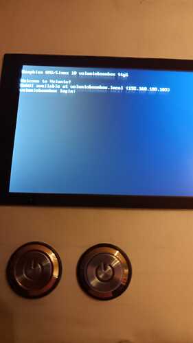

On my new DIY boombox i run in to a issue with the touchscreen.
Only part of the screen does react to touch.
On the pic below the green area works fine, the red part does not react.
Volumio
The screen is correctly oriented and the part, which works fine with touch obviously too, so there is no screen orientation issue.

I rewrote the last stable image to the SD card, setup the display essentials, then started DEV and hit the update to 3.772. Update successful, display still works, but can’t get pas this:
Volumio is not reachable on that address, SSH does work…
Never mind, went back to stable. Touch screen still works only partially. It also may be just hardware failure on Waveshares side. For now, I have no time to troubleshoot… Will use remote control only for now.
