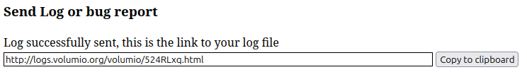

  1. 4.119 … and every version since I started using couple of months ago
  2. What is a log link? I used /dev " Send Log or bug report" to send, I was told to copy/paste system log, I sent you a https://paste.rs/84Nya
  3. sent you a log over /dev
  4. PI4 on SDCard and PI5 (with and without NVme)
5A official RPI PSU, 5A Meanwell, 16A variable voltage, current limiting PSU
Reproduced on a fresh install (what I sent), on a one month old install
And I made you a video of me reproducing it on Tidal IMG_8327.mp4
And reproducing it on Spotify IMG_8328.mp4
and again system log (please use the link above becauase I can post two links per post… paste.rs above)

  1. image
  2. image
  3. image
  4. CTRL+V
  5. image
NO LOGS = NO HELP
http://logs.volumio.org/volumio/ULtZtd7.html
