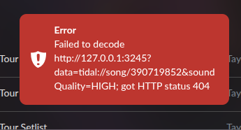

I’ve attached the error message
Screenshot from 2025-08-16 12-15-44

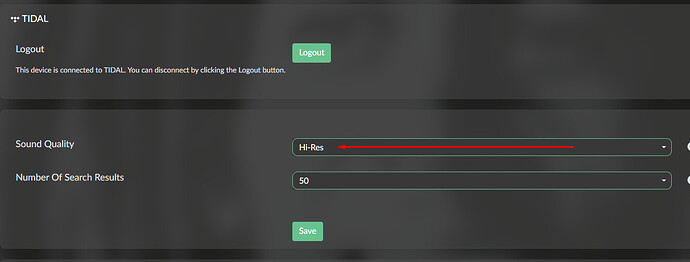

Try with a few different tracks and set Sound Quality to Hi-Res.

set to hi-res

sadly still no noise, just the error message
