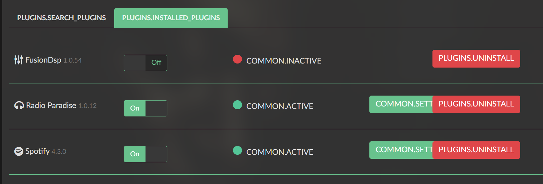

Dec 29 16:52:26 rivoplus mpd[30531]: Dec 29 16:52 : decoder: Decoder plugin 'wildmidi' is unavailable: configuration file does not exist: /etc/timidity/timidity.cfg
Did you install TiMidity++ or a MIDI playback plugin?

The only plugins i have installed is as follows:-
