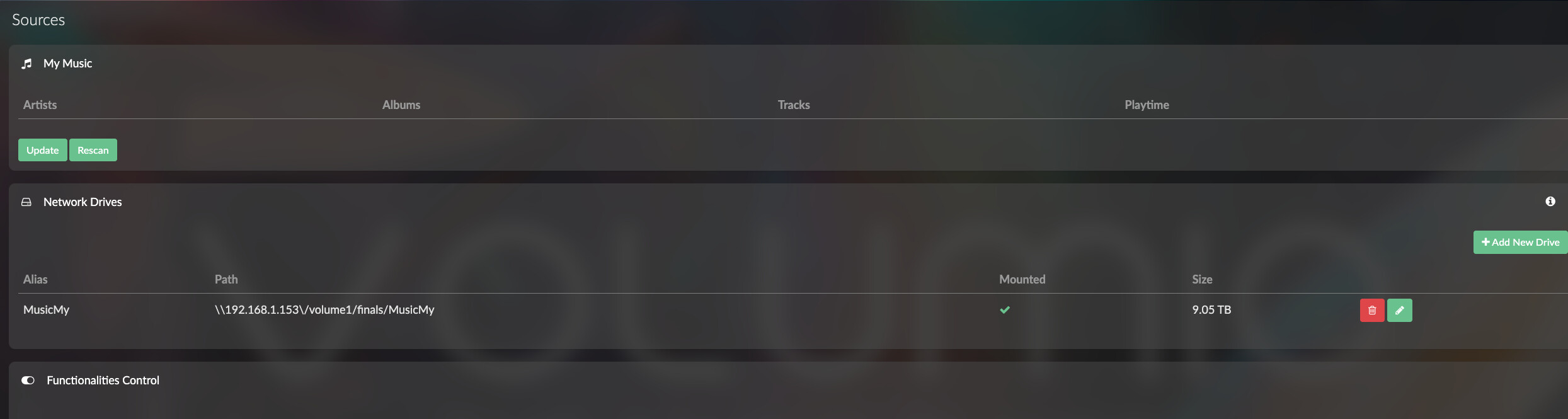

After upgrading to version 3.528
There is a problem with nfs connection , mounted disk is available in ssh console as well as all files . But there is no track in the sources section.
The same shows nfs connection - ok
rebooting does not help

there are changes. there are 0 in the columns aritist, album and so on.
But music files on nfs does not see and does not scan

upd
After power off , started scanning the nfs directory
http://logs.volumio.org/volumio/9Z5AXTs.html
Problem with nfs - hopefully solved
ps was my mistake. I enabled Test Mode - True.
I didn’t realize that the update came from the dev branch ( I didn’t see a warning anywhere ) . And now I’m on the test version
