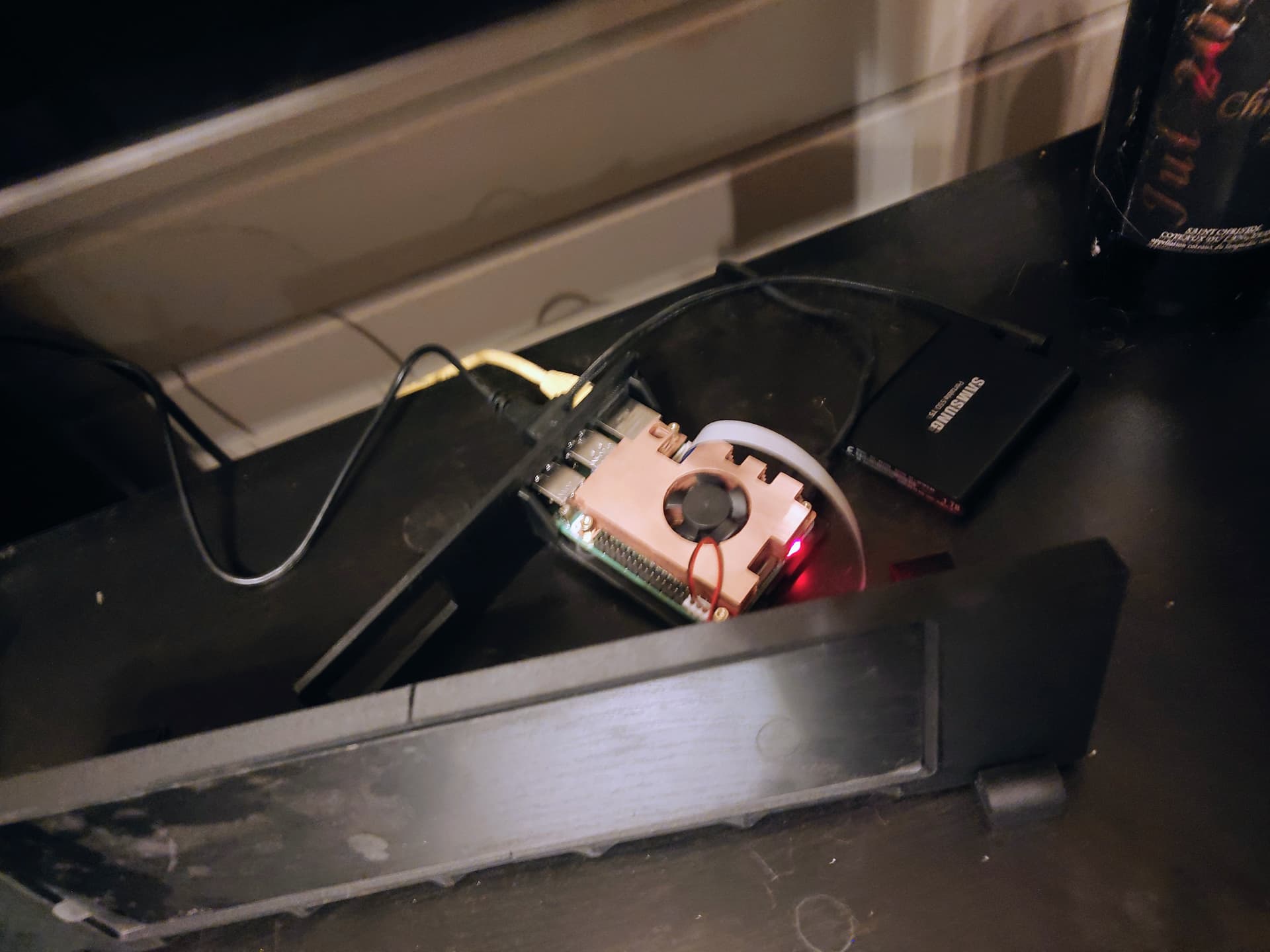

Wile waiting for well most of the items in the list above i still need music!
So this is the current situation :rofl:
And this is the point of this build, nothing but a pi and a screen, this is what you need.

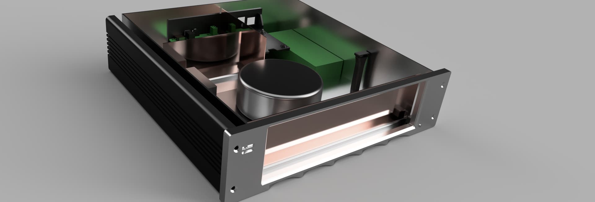

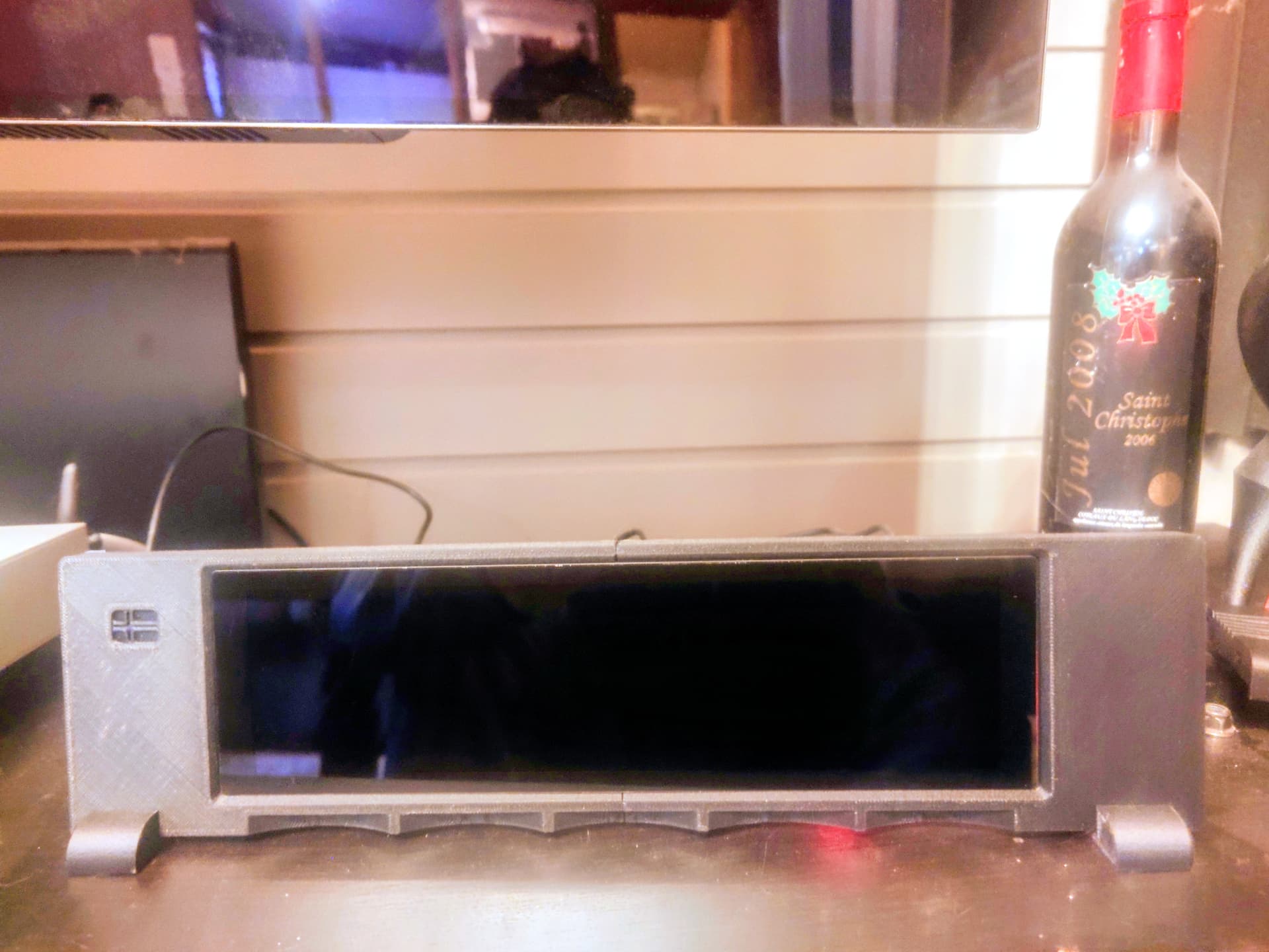

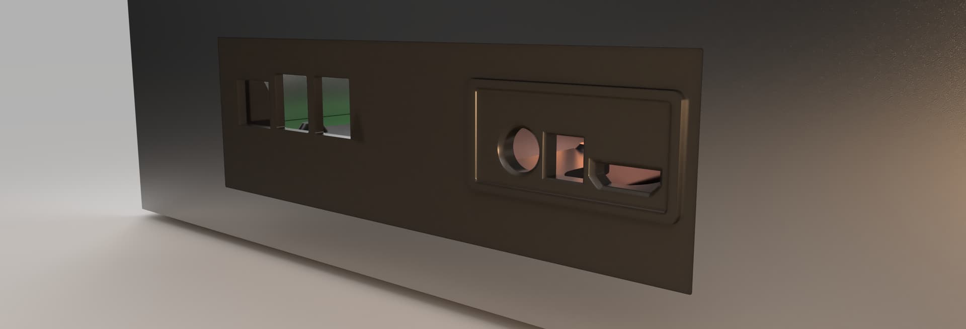

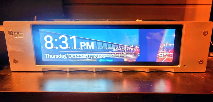

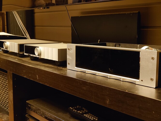

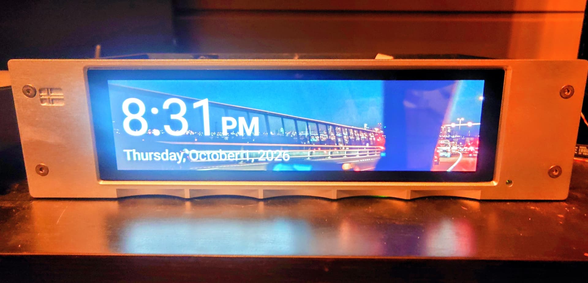

Today i got the faceplate in the mail.
Sadly i did not account for the anodizing when modeling. But being an old mechanic has its perks :wink:
Doubt the screen will need any other fasteners to stay put lets just end with that.
However i was alitle puzzled by the fact this came first, being ordered last and all.
Uppon further checking seems i had not ran the order with audiophonics to the end* end🤦‍♂️

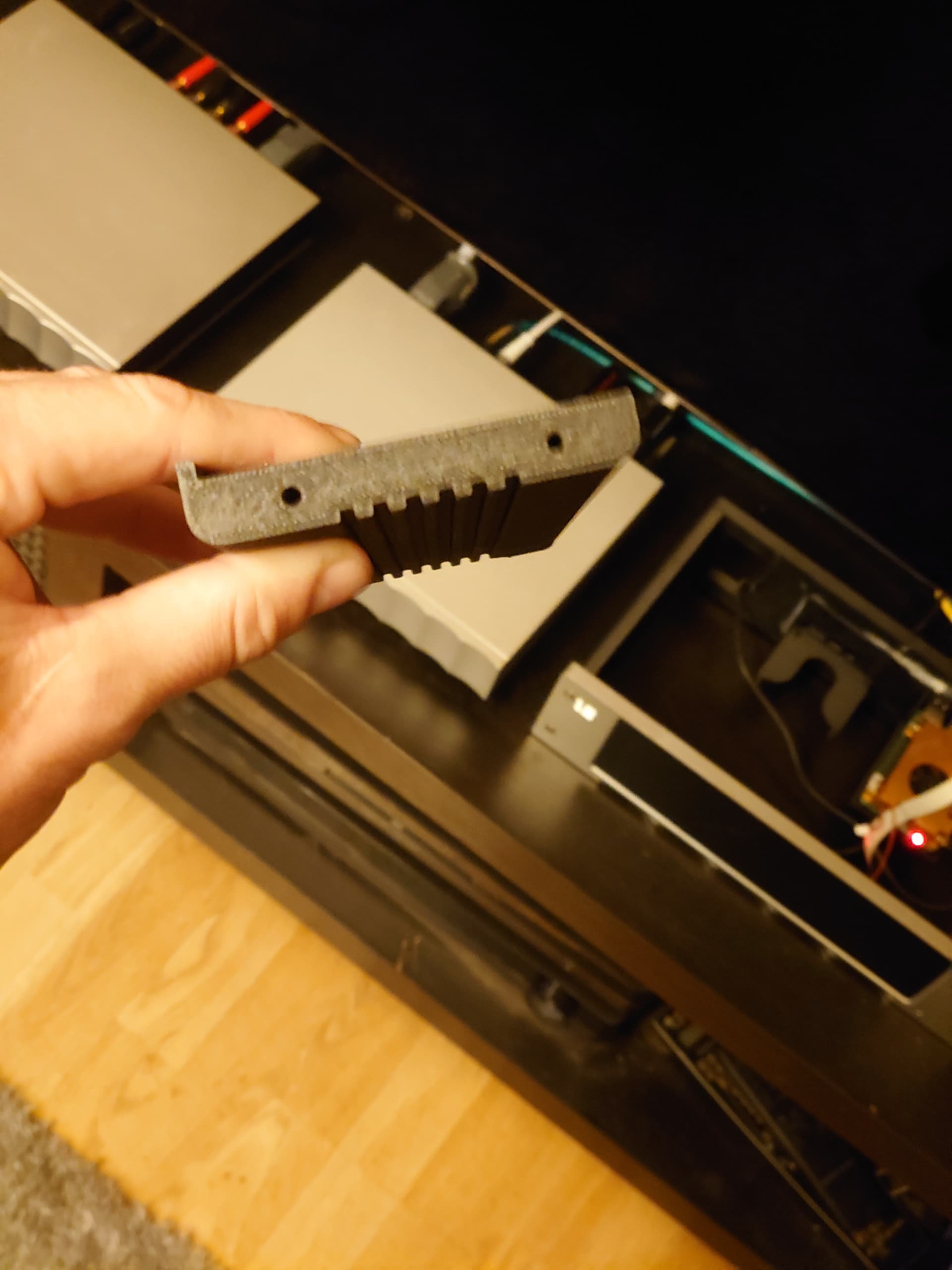

I already had the side pieces modeled upp in cad so tossing them at the printer would be just a game of waiting realy.
Still the issue of the short pfc so i will have to make
“In the meenwile” adjustments while i wait for those.

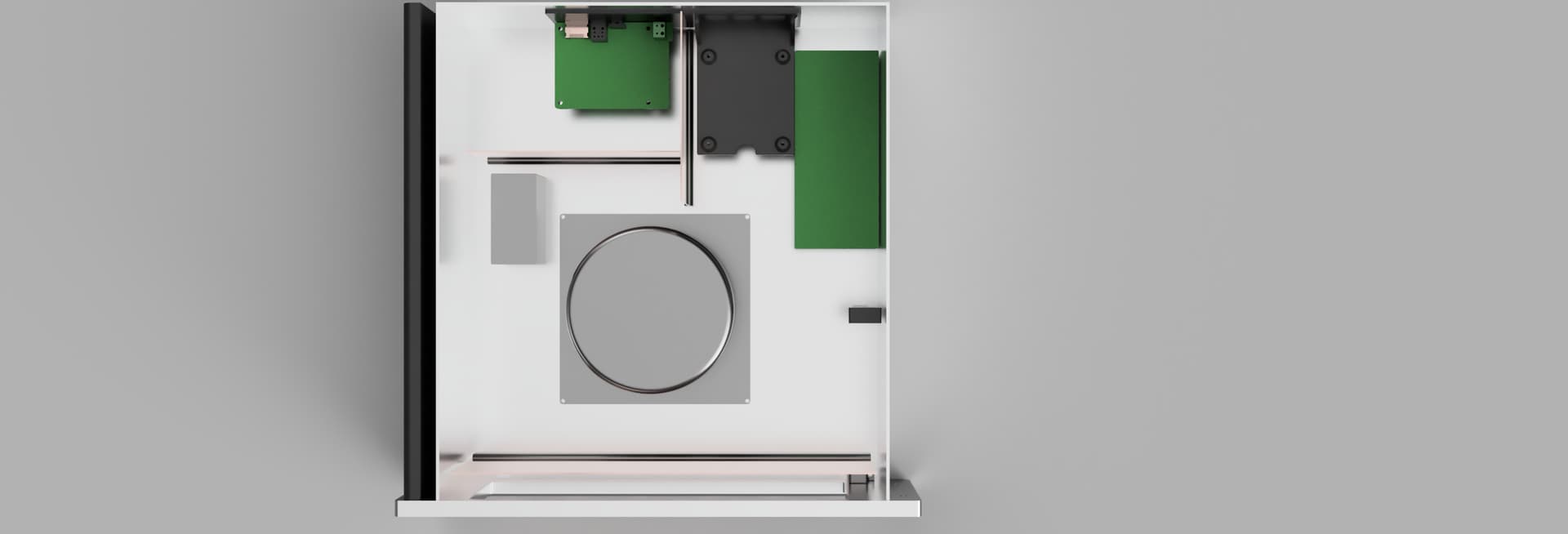

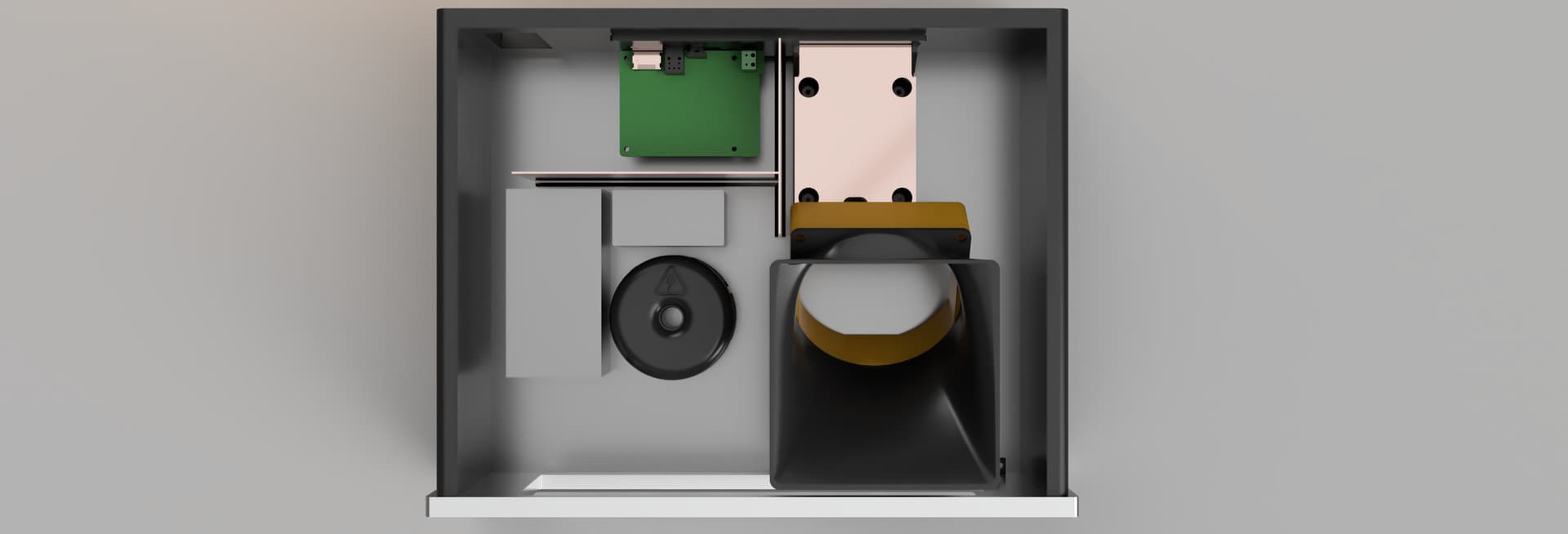

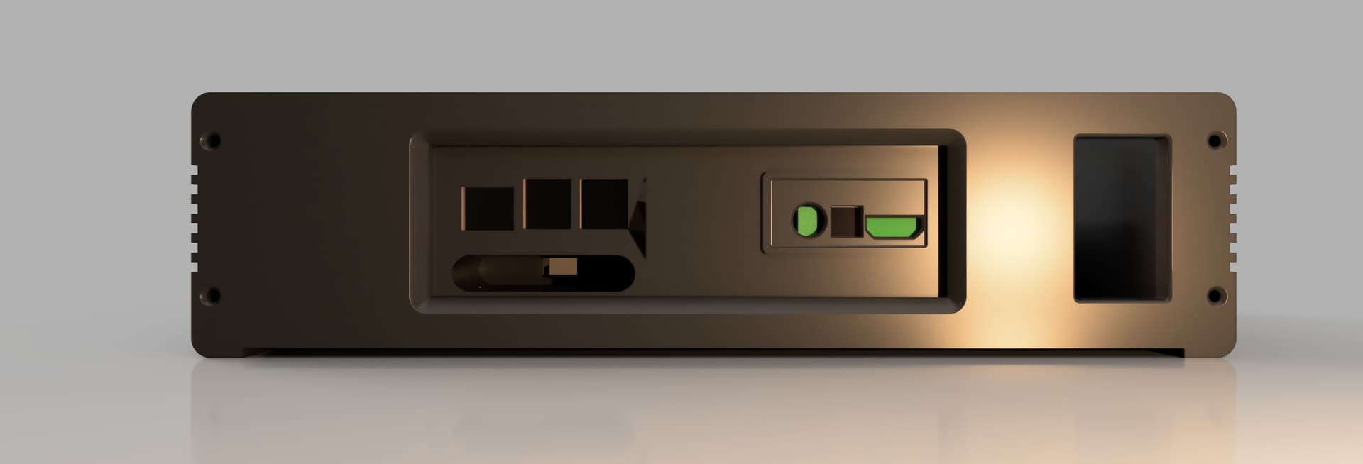

Revision changes.
Yes that slot under the pi looks wierd.
BUT! i found an old samsung t5 ssds in the midst om my “junk”
And having a sort of old style cartridge system just fancied something in me.
Also changed arround the power situation, after all i realised that feeding linear to a cpu will be mostly worthles.
This leaves room for a smaler suuply for the audio path later on if i even descide i want to.

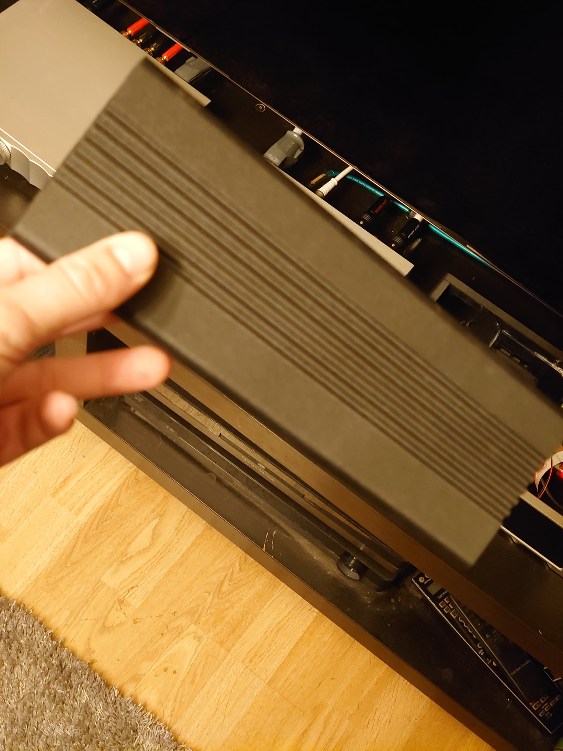

Side pannels turned out greater than i thought, printed in asa-cf so heat should be noe problem.
Also built on the meassurements from the hifi2000 galaxy so mix\mashups could be possible later :man_shrugging:
Lcd did not situate as far back as designed for due to mentioned issues. I think its ok, back will be filled inn with rtv to hide the crack. Color match not even close, id have to look into that.
Also dissregard the dusty hd990 :face_with_peeking_eye: And the dusty bench :flushed:
