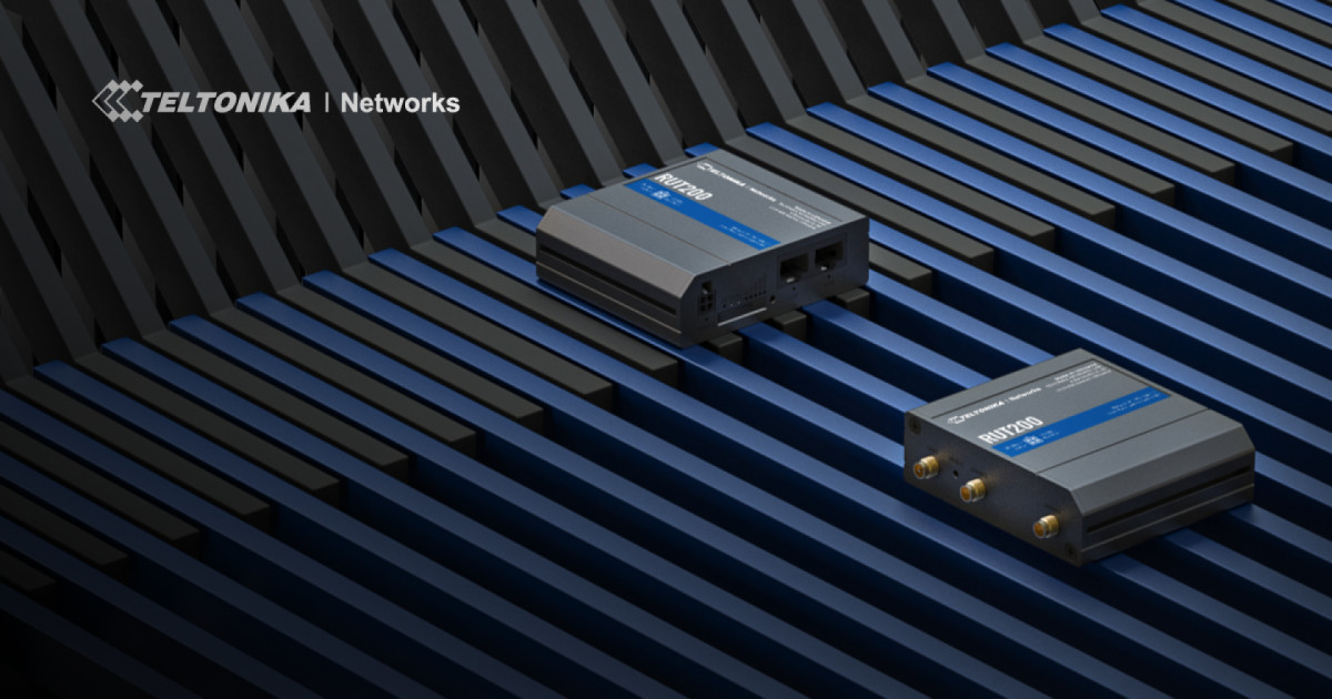

Possible solution: something like this, a 4G/LTE router, where you put the SIMcard. Then you have full feature WiFi in the car. It can be powered straight from the cars 12V. You can hide it under dashboard, you will never need to access it…
Unfortunately I can’t use the phone on a WiFi network because I use it on wireless CarPlay and that ties up the WiFi connection from the phone… I just wondered if there was some setting I could adjust to get it to see it on the same network
