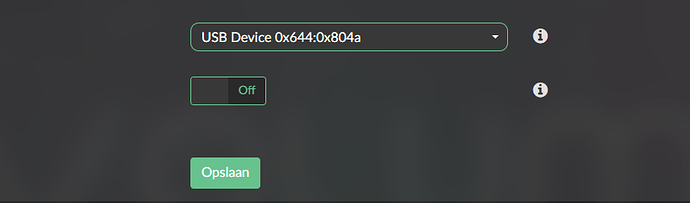

I turned off sleepmode. But Teac is still not responing.

Once you disabled it. Turn off and on the TEAC, Turn on Volumio, select USB Audio output and try.
