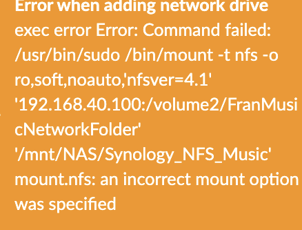

Thanks Wheaton. Where do I specify the NFS mount options? Is that within the Volumio configurations (e.g. “options” in the network drive configuration)? I tried entering * nfsvers=3 in the options field but got an error saving (it flashed so quickly I could not read). When I went back to look, it was not there.
I also tried going into the Synology NFS configuration. It was set at “maximum NFS protocol NFSv3”. I changed to NFSv4 then rebooted Primo . . . that did not fix. I changed to NFSv4.1 then rebooted Primo . . . that did not work.

OK. I did the factory reset. I tried all three of those settings on the Source–>AdvancedOptions–>Options. The first setting, I was allowed to save but it still did not mount. The second and third settings, I was not allowed to save. I got the message …
