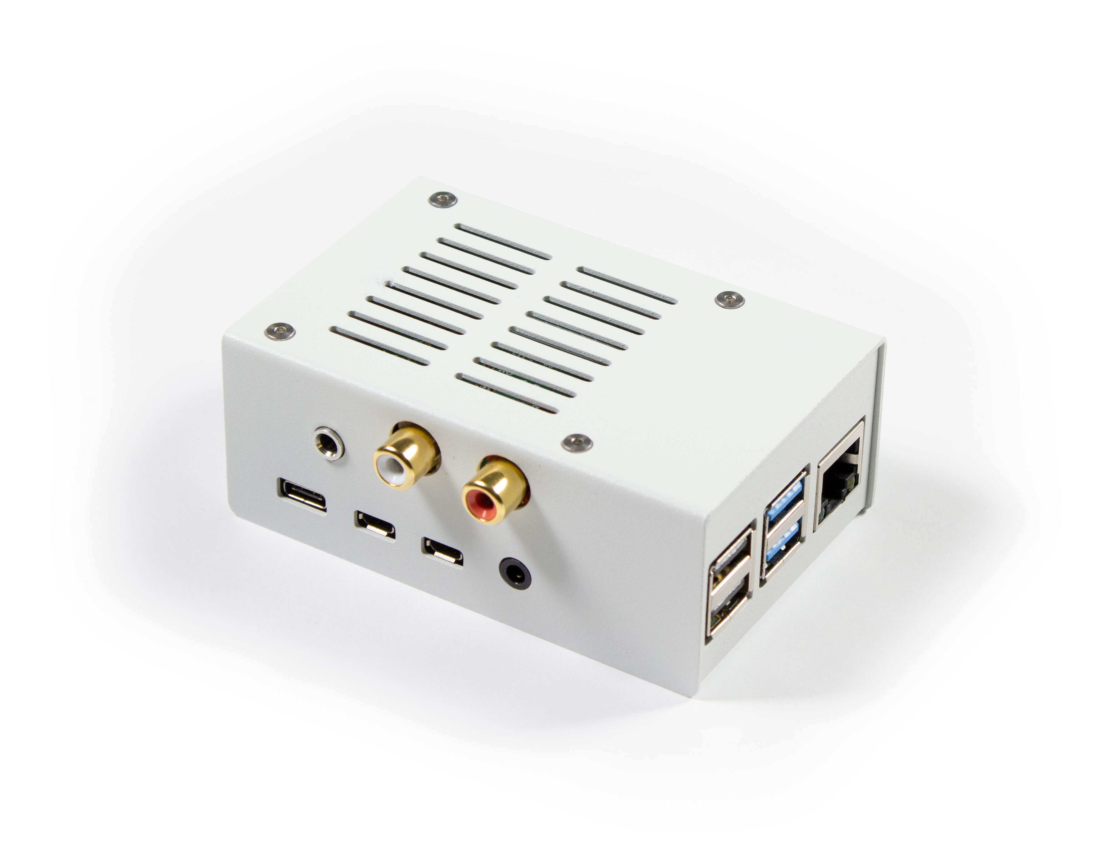

Yes, that’s what I have also wrote about, that budget HiFiBerry case is more on the ugly side too (maybe if there would be a white version, but isn’t), and also is the only one I have found for the IQaudio DAC so far, that’s still available. Maybe the HighPi ones would also do, but the Pi3 version is out of stock everywhere I have looked. Compared to my current case (simply the official and budget one, but still decent looking), they’re all seem just ugly. I thought I would have much more options, specially if I rather choose the HiFiBerry option, but their more acceptable looking metallic case for Pi3 is all out of stock again everywhere I have looked, even on their official site, there only the Pi4 version available now (guess the Pi3 version is being discontinued). E.g. this one looks quite acceptable, but I have not found any, even similarly looking for Pi3.
