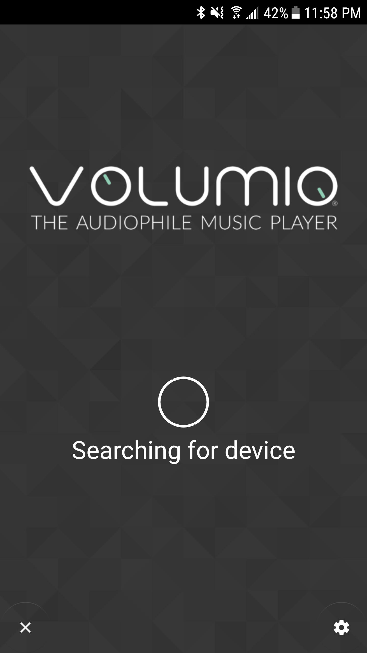

Hi new here I use the latest version of volumio .
I install the plugging spotify and spotify.
And when I need to get it active…it show a never ending round that search…and when I checked if it’s active …it is still not activated…what do I need to do???
I want it on my computer and android to play the music on the volumio with aoide dac ii.!!!
And this on android…searching for device when enabling spotify.
