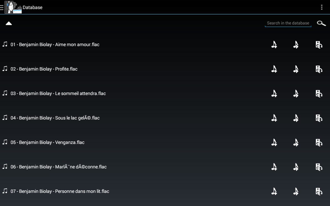

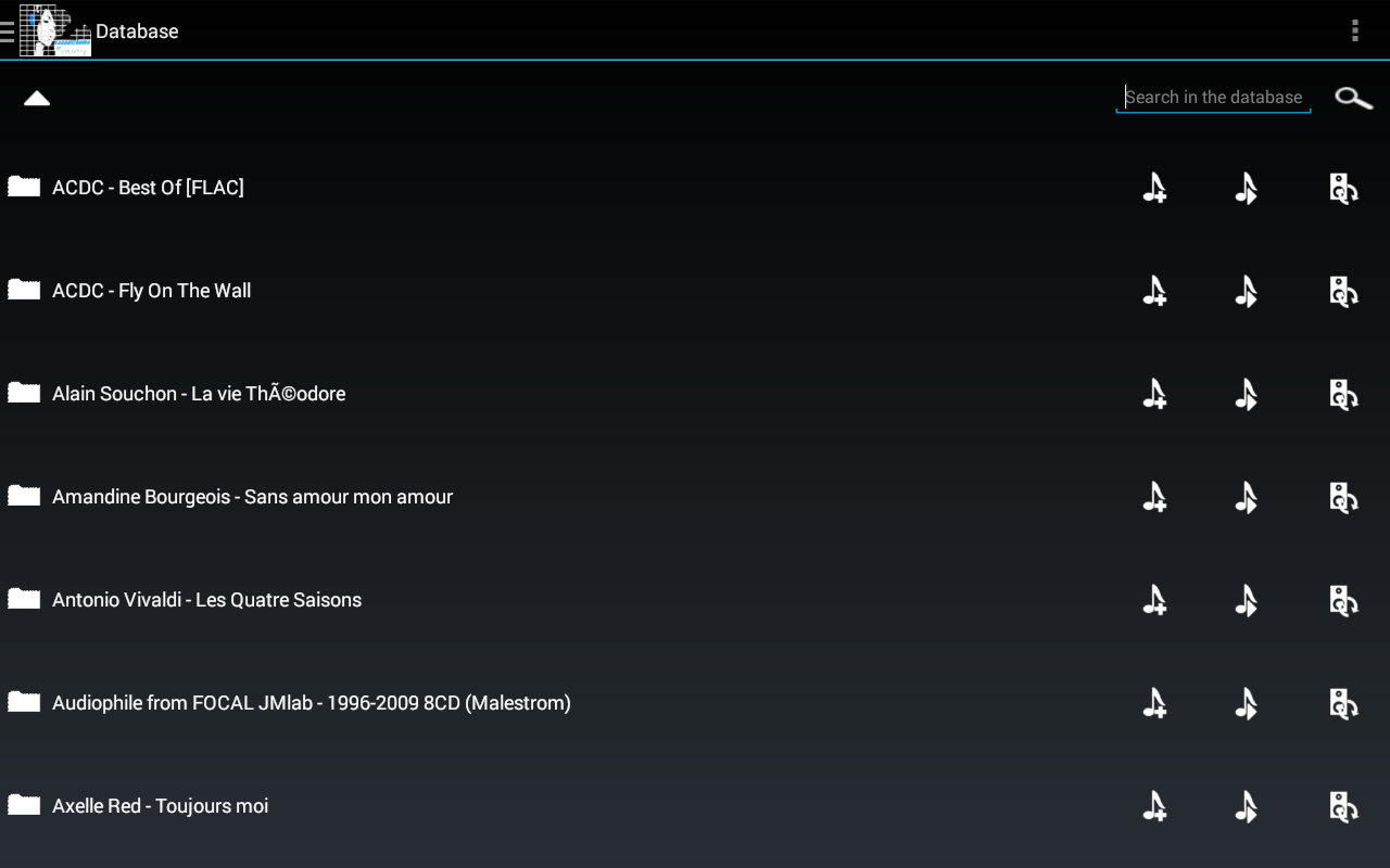

Digx,
For the first case, I use the file mode. So I can see the artist name with wrong caracters (please see picture)
Screenshot_2014-11-11-16-58-52.png 3rd line. But if I select no files appears.
Second case, with other artist ( without special caracters) I see all songs, but if I select one with special caracters (see picture 2), I ve got the message : “error connecting to the device”.
Hope it’s clearest… Tell me if you need other explanations
Regards
