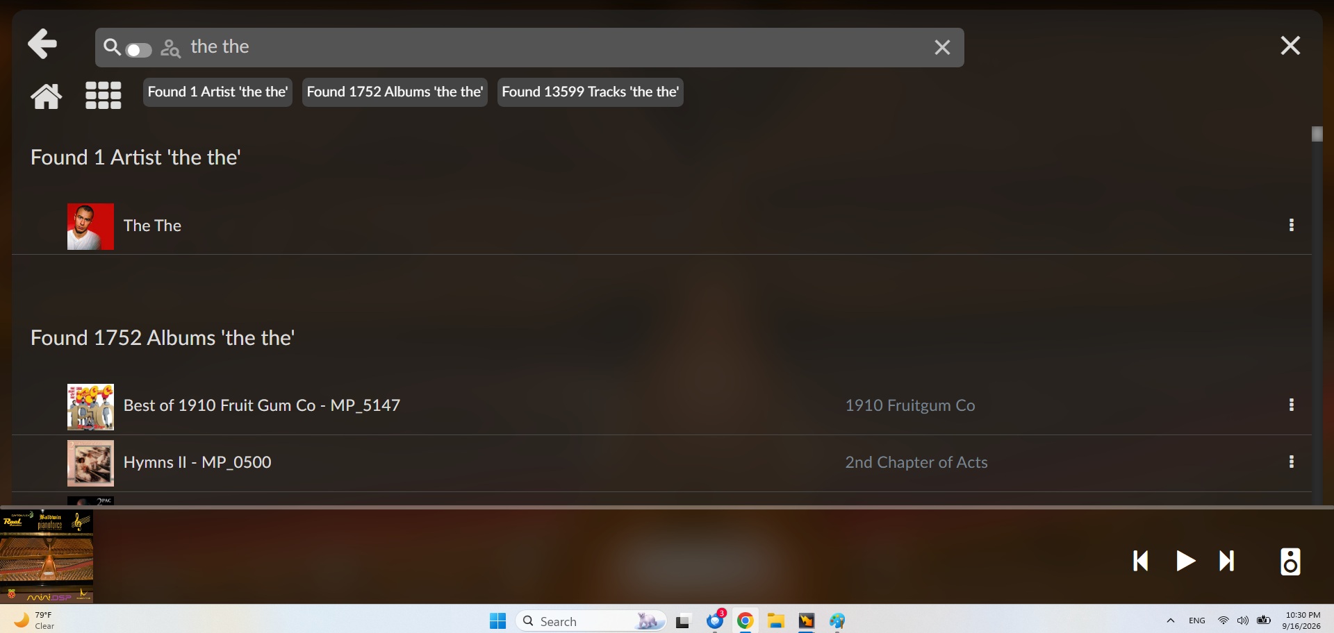

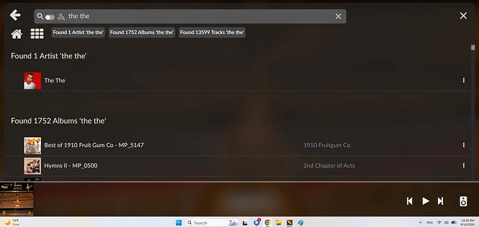

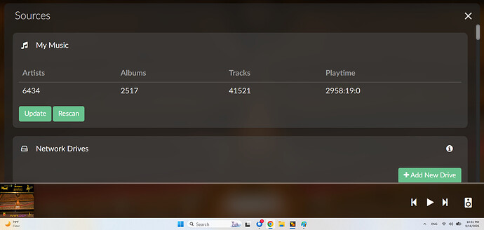

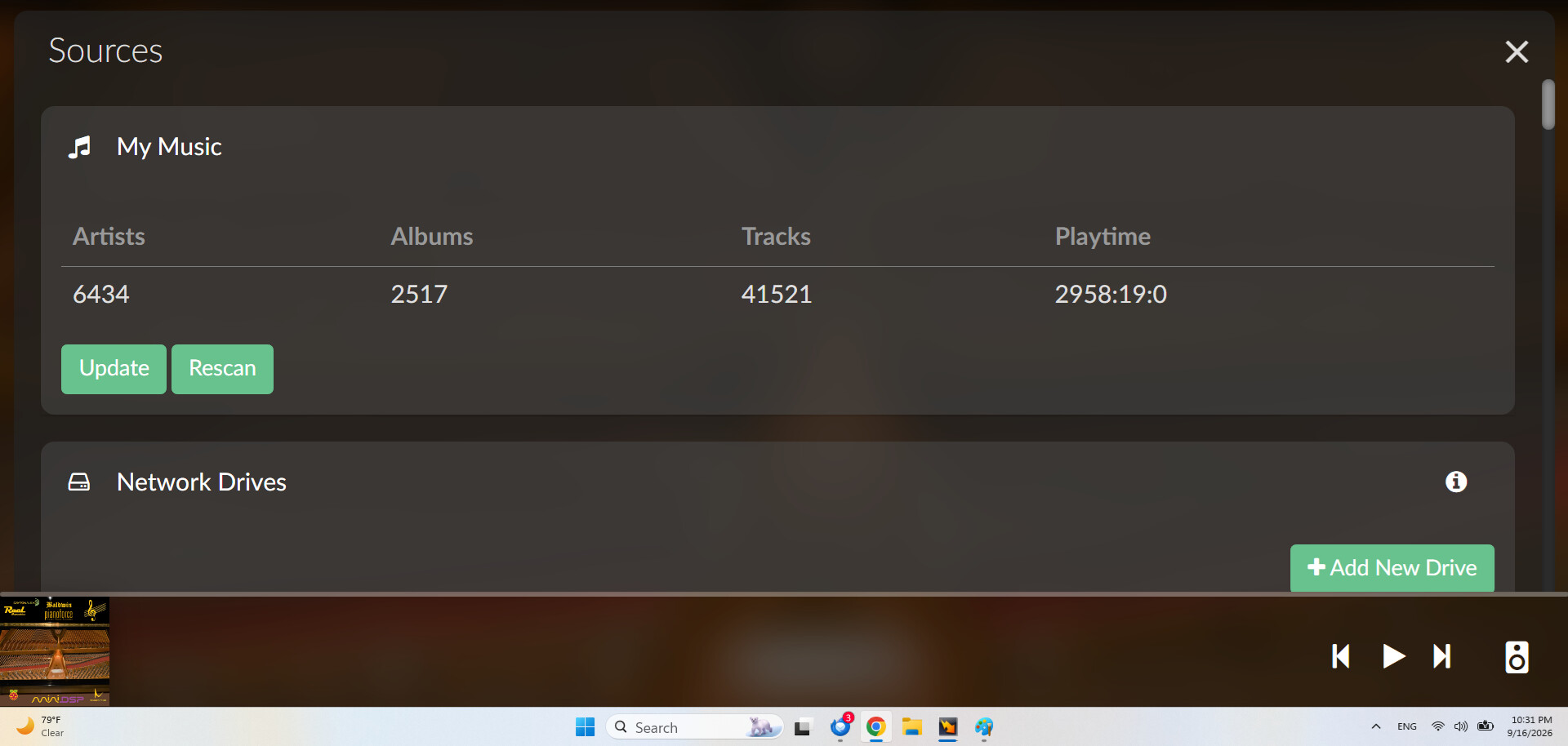

Bump:
Here’s how I’ve learned to deal with “The” in my large library:
For Artists: Use preceding “The” ONLY for one-word names as in “The Beatles”, “The The” or “The O-Jays”. Omit the leading “The” from all Artists of two or more names.
For Titles: Remove all preceding “The” instances.
The alternative comes at a cost that increased with the size of the library and it is an ALL-OR-NOTHING option in order to work properly.
You can add “ArtistSort” and “TitleSort” tags. In this case all instances of a preceding “The” must be in the format of “Beatles, The” or “The, The”. The standard “Artist” and “Title” tags are then stored with the leading “The” deleted with the exception of “The, The” which remains “The, The”.
