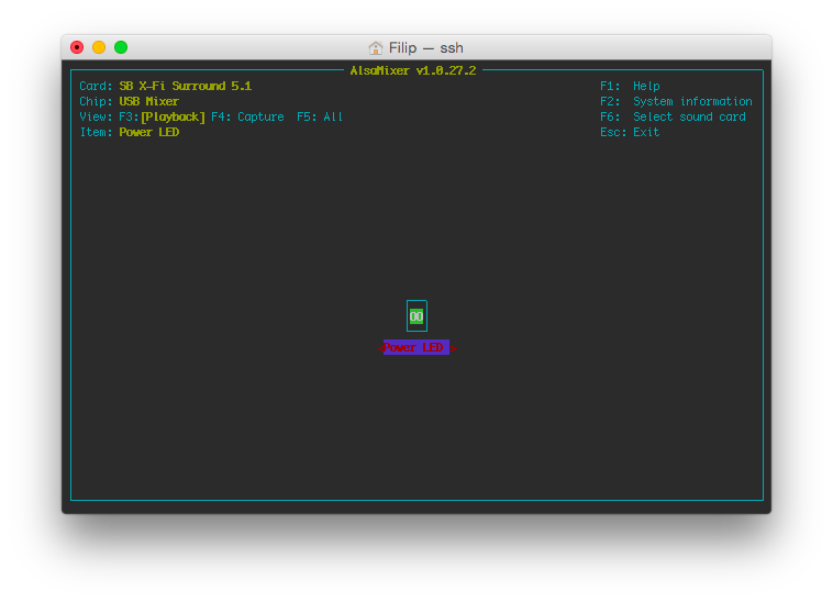

If not, connect via SSH and check the volumes with
alsamixer
If you can post a screenshot of what you see in alsamixer
Ok then. Just tell me what information do You need and I will provide it :wink: I am noob when it comes to Linux :slight_smile:
I turned on Pi with my DAC attached several times and it didn’t help :frowning:
I can’t change volume in alsamixer. Here’s what I see:
EDIT:
I don’t know why and how is that possible, but I have just heard startup sound from my speakers. The only thing I have done was running alsamixer over ssh. I didn’t reboot Pi. And it was running half an hour before that.
WebUI is working. AirPlay not.
After 2-3 minutes: AirPlay showed up on my iPhone. When pressed play there is no sound. Maybe few seconds of little noise (but not loud, just radom noise for second or two).
Still same view in alsamixer and no audio though USB DAC.
After next minutes (did nothing, Pi plugged as it was): I heard this noise again. It appears to be sound that come from DAC when I play music though AirPlay. I assume that DAC is working but not as it should :slight_smile:
