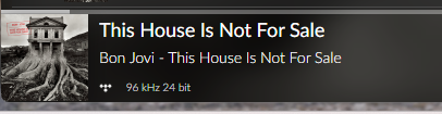

Cannot get the Volumio Primo Plus to show anything more than 44.1 khz and 16 bit from Tidal Hifi, no matter what. Set the streaming quality to “Hi-Res” logged in and back from Tidal (only using native Volumio Tidal App, no Tidal Connect).
What is going on.
Jacob Ponsrox
Sound like you’re picking 44.1 kHz or MQA files.
Just tested a new release to be sure it’s not polluted with MQA.
And it shows 48kHz/96kHz on my Primo Plus.
