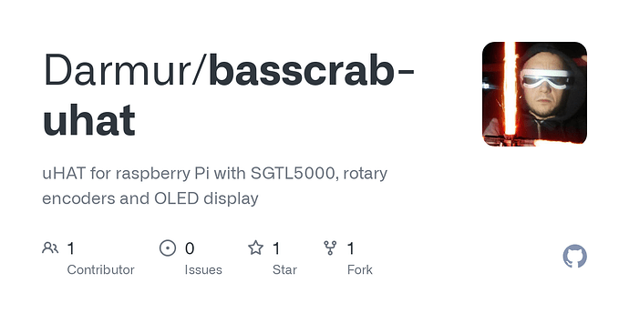

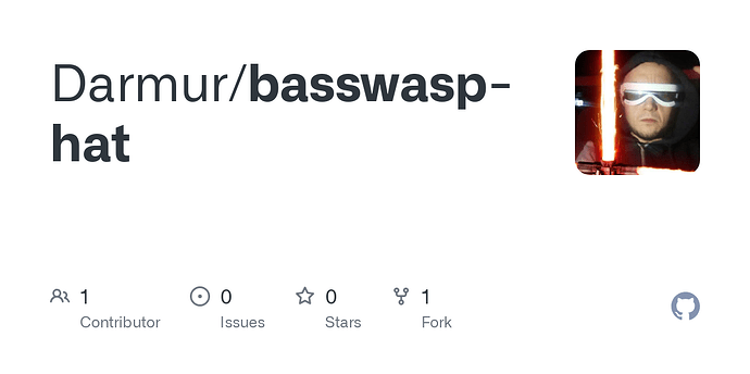

BTW, during the last months I released some other HATs for Raspberry Pi, both on PCBWay and my Github
BassCrab looks nice… how can I order couple of them?

I have two samples only, with components soldered manually… I will let you know If I will trigger production of a small batch
Maybe we can organise a group buy if we have enough interest.
no problem with that! I can help to order the assembled PCBs if necessary
