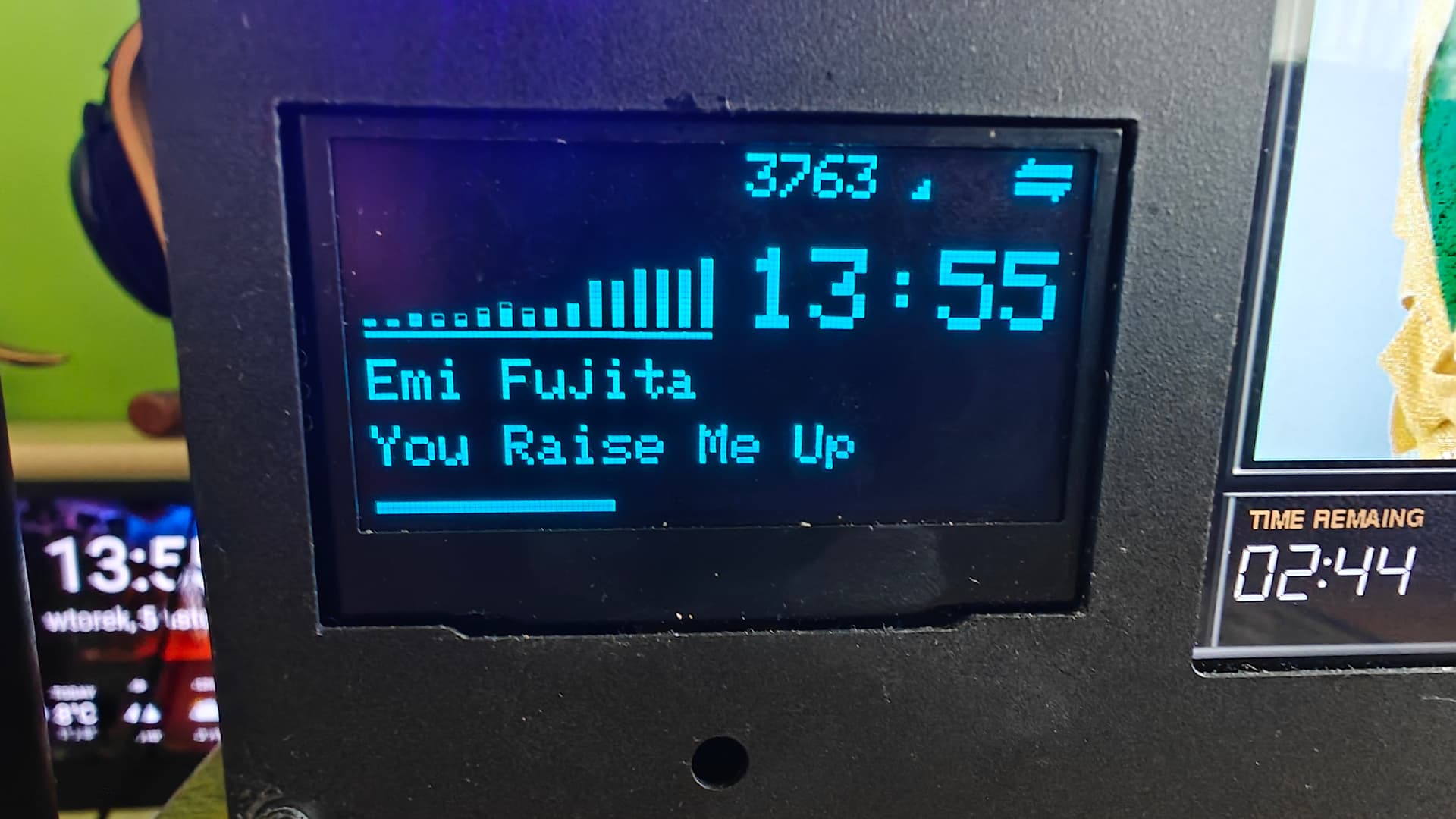

I only want a small VU meter for a bespoke Pi case.
for eg 3.5
or
mpdoled (not for Peppy - mpdoled plugin)
0,96 inch OLED-displaymodule, 128x64 pixels I2C SSD1306 lichtgevende OLED-schermbord compatibel met Arduino Raspberry Pi ESP32 - AliExpress 502
