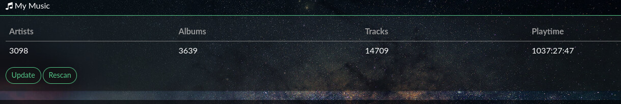

Scanning stopped at 4566 track when my nas folder holds more then 10 000 tracks
anyone else having issues with new version 3.804 not scanning the nas music library completly , ive installed a old version and its scanned all my music 10 000+ tracks now with the new version it goes until it reaches 4566 tracks then just stop’s update or rescan dosent do nothing

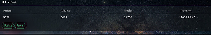

I have for few weeks problem with my volumio setup dont want to scan and save my nas library .

it’s not really a nas it’s a 8tb hard drive in my windows 11 computer and when i add it to the list i specify vers=3.0 and the .34 ip is wrong that was the volumio ip that i entered by mistake ,33 is the right one and theres no error’s it just stops scanning but still saying info: CoreCommandRouter::executeOnPlugin: mpd , getMyCollectionStats even after 2 hours of letting it do its thing , so went back to version 3.61 the only one thats scan’s all my 44 670 tracks
did not help for me it crashed my install of volumio so went back to version 3.61 the only one thats works for me and the 44670 track i have in my windows pc
@c4shd34d
Without any logs, I can’t support.
no problem , i got the problem fixed by installing the test version 3.913 it had no problem finding my 44 000 tracks of flac and dsd on my smb share on my windows 11 computer but thanks for trying to help anyway
