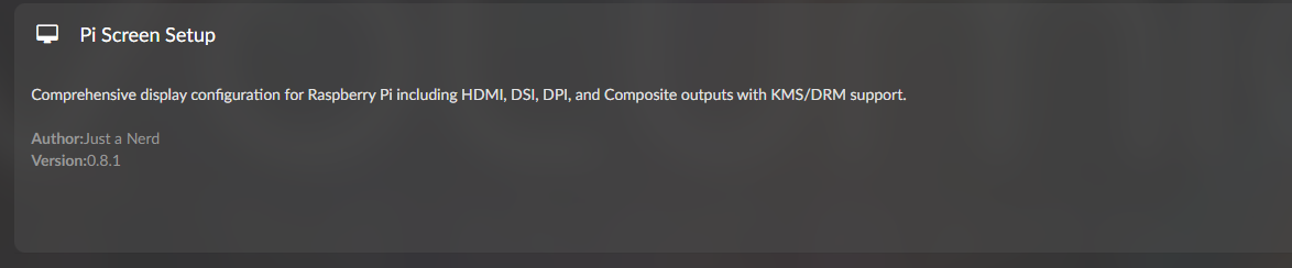

There is also a plugin to do the work for you:
