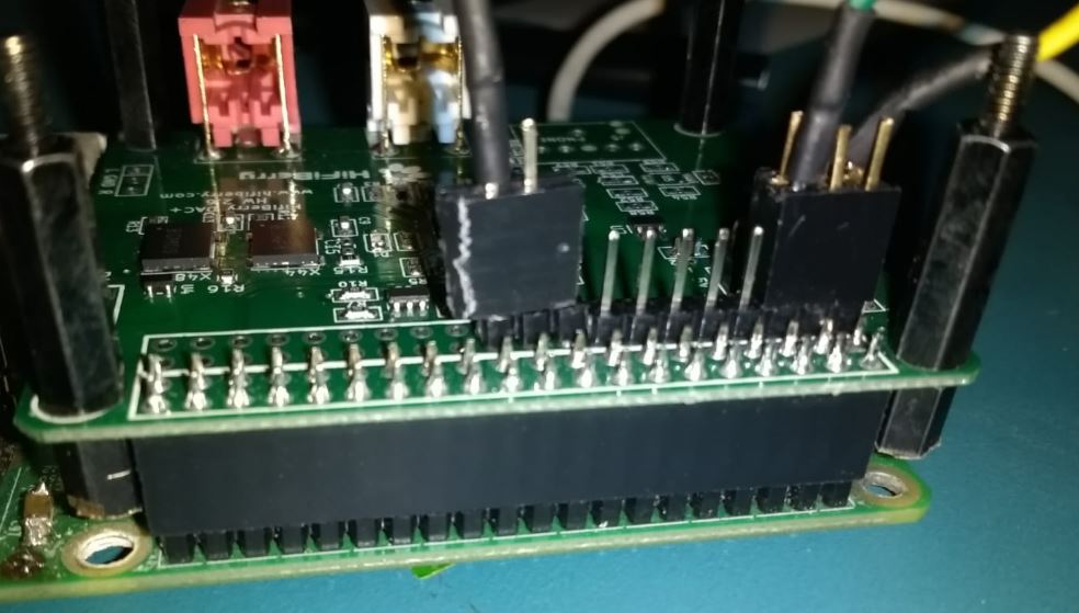

On the Hifiberry i soldered extra pins to connect the IR receiver. Did the same thing. No signals. Then i found out that GPIO18 (wich i first used) is being used by hifiberry. So i changed to gpio23. No diffrence (changed settings). Then i took of the hifiberry of the rpi, and set the IR receiver direct on the pi, OK signals coming in.

Gpio23 is pin 16 on the 40-pin header (https://pinout.xyz/pinout/pin16_gpio23#). Looking at your picture it seems that you connected to pin 22 which would be gpio25.
Edit:
I am using a Hifiberry DAC Plus and the IR receiver of a RemotePi board. As that IR receiver needs gpio18 or gpio17 I am using the latter which works flawlessly. For this reason I did not try out gpio23 or gpio25 but never read that the Hifiberry would block gpios which are not used by itself.
