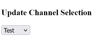

Now I wonder how it got to be on the beta channel
Screenshot 2025-06-09 at 18-43-36 Volumio Test Player
Must have changed it with an earlier test report. It would be useful if it were clear I was on beta in the system menu, maybe call it 3.815B
