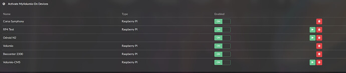

I just did a test. I filled up the six slots of my lifetime premium subscription (gmail) with non premium devices:

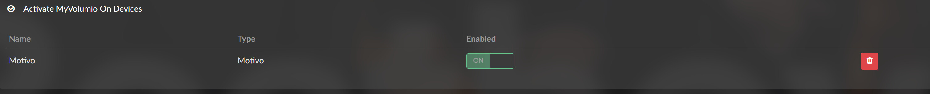

Next I added Motivo to my free (outlook) volumio account. It did not ask me to log out from another device. So @Wheaten 's trick with the second email address seems to be working for the time being.
It should work indeed.
But hey, you had me sweating when you said it was failing!
It’s a solid work around, for the time being. As what I understood it needs some severe research.
