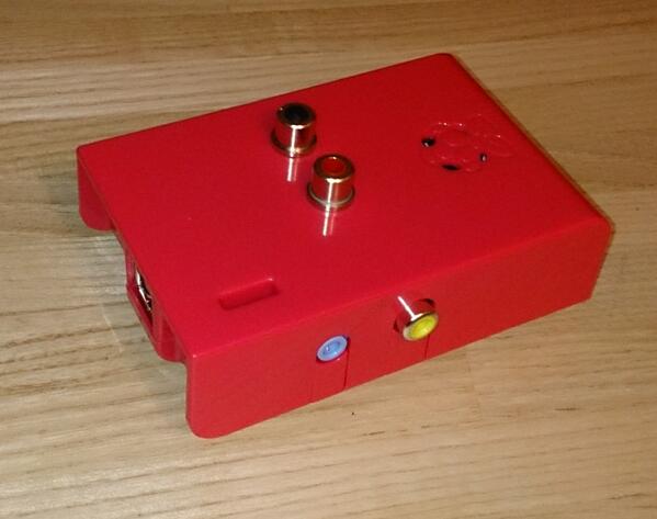

Farnell are selling a CamdenBoss box marketed as being for the Pi and the Wolfson Pi audio card uk.farnell.com/camdenboss/wolfso … nAudioCard
The Wolfson Pi card is one that fits on top of the Pi, so it may be that the CamdenBoss box would work for you if you got the HifiBerry or the IQ Audio Pi-Dac.
Here are some examples from the HifiBerry website, the IQaudIO Pi-DAC looks around the same size as the Hifiberry:
hifiberry.com/guides/gallery … creations/
