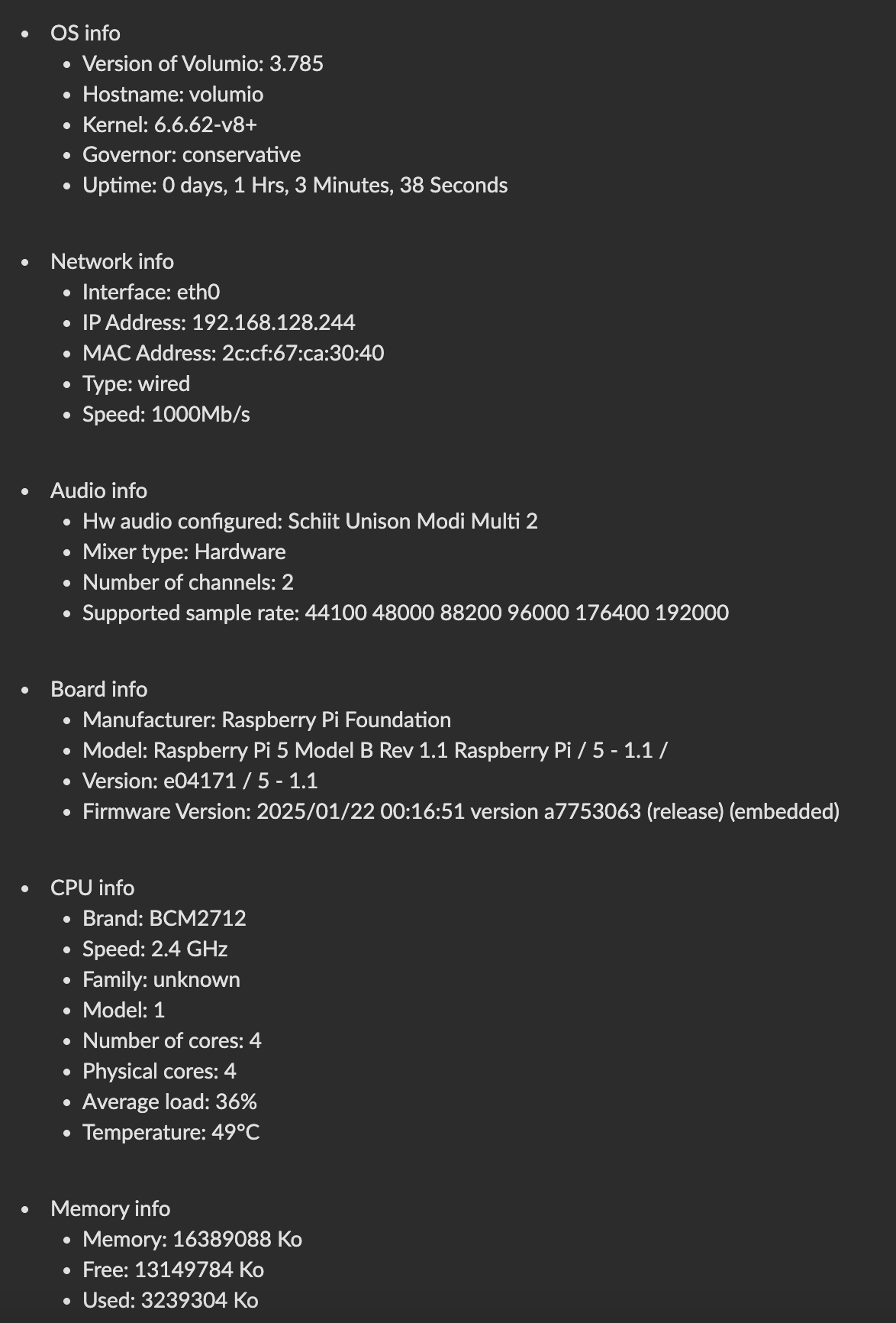

Hey @Abdallah_Atie,
Can you install System info plugin and post screenshot? Perhaps your Pi5 PCB has a region specific version, hence why install to disc may have not been offered.
Issue is that I am not able to search available plugins for some reason…
