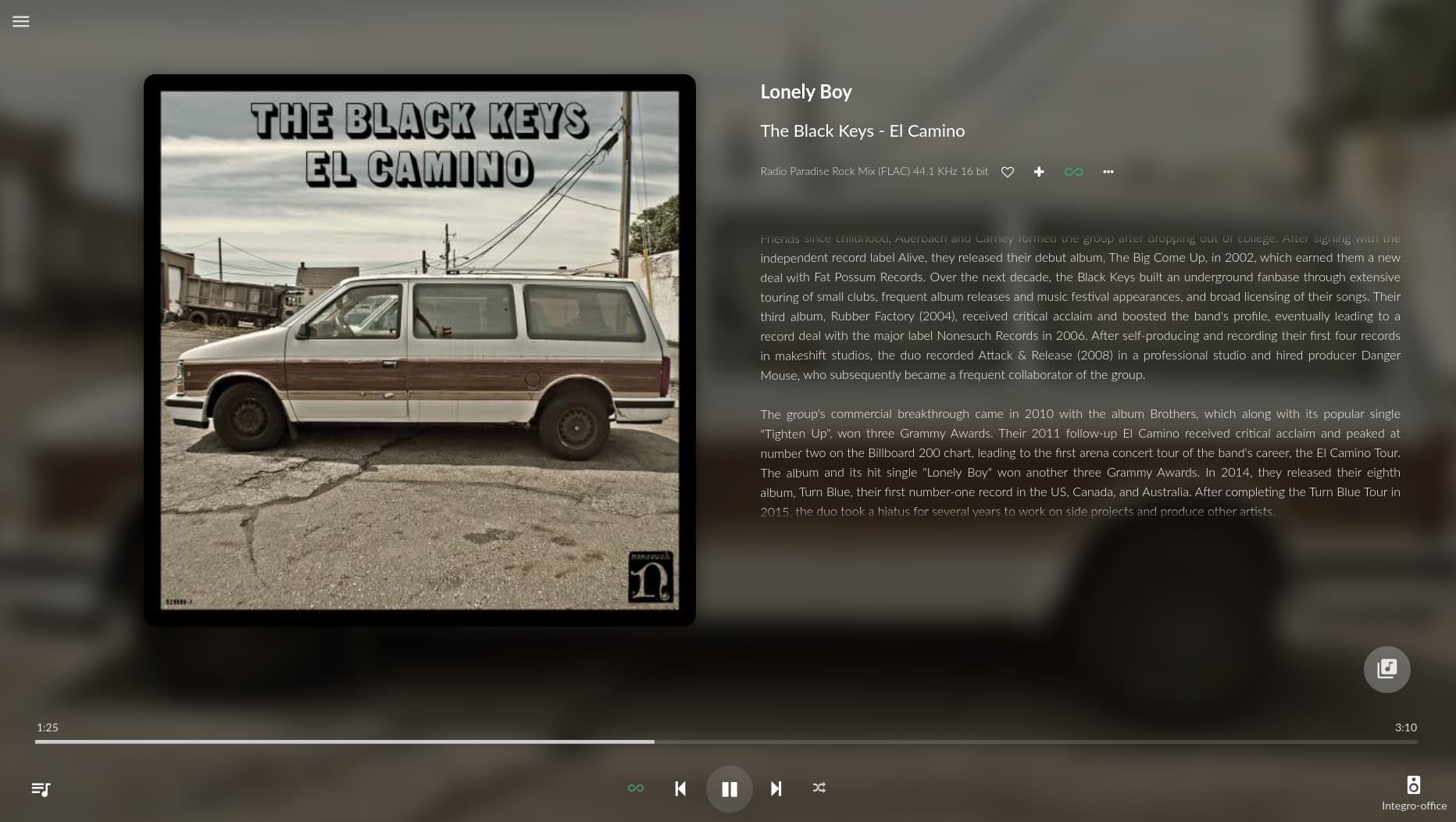

But, if you install the plugin Radioparadise, it ok with only a 10 seconds drift.
So, install the plugin ![]()
And you’ll get album art

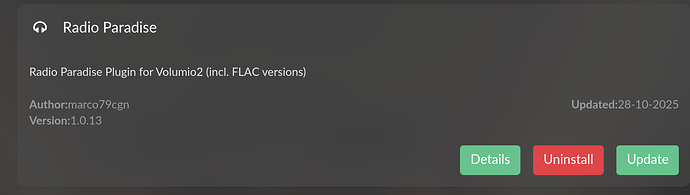

Thank you for your feedback. The problem I am describing happens with the plugin. I tried several times to uninstall it and reinstall it but the problem remains. Oddly the Radio paradise plugin version in the list of plugins in the Volumio app is 1.0.14 but once installed, it mentions the version 1.0.12 (I don’t know how relevant this is…?). What I have noticed is that the information displayed on the Volumio app on the iPhone is always synchronized with the music broadcasted by Radio paradise live (for example through its proprietary app) but very often (more so than not) the music played by the Volumio Rivo + through Radio paradise plugin does not correspond to the display (which is in synch with the live broadcast of the radio). The lag is in the 5 to 10 minutes range so a few songs. Marco from Volumio told me that the third party plugin is most likely responsible for the problem, not the hardware (Volumio rivo+) or the Volumio app. He advised me to reach out to the community. I also get sometimes an error 404 when the Volumio rivo+ is unable to connect with the Radio paradise http address. I need to mention that when it happens the Volumio rivo+ connects without problem to the streaming platform I use. So it’s not related to a wifi connection issue.

The last version you see is only for Volumio 4, not deployed yet for Volumio hardware.
But this is not the reason for the drift. The plugin get the stream from radio paradise servers. Last version just add new streams.
