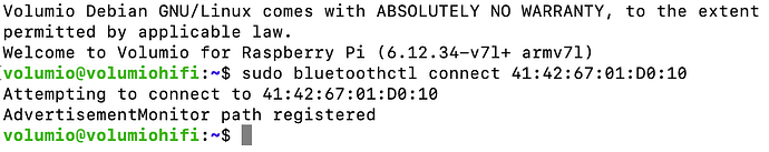

My Remote control is LE without usb dongle and just “connect” unfortunately, is not enough.
How to create a boot script (or what?) that will execute two commands: bluetoothctl and scan on? Thanx.

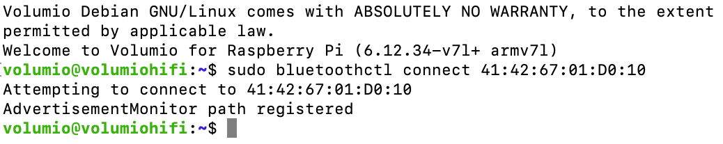

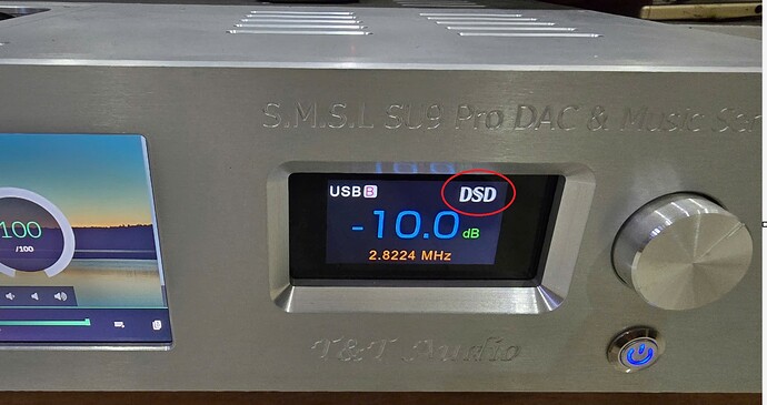

However, there is a problem related to some music file formats in my library - *.APE and DSD. I use DAC SMSL SU9 Pro (Output device: SMSL USB Audio), when listening to music with Volumio 3.xxx everything is normal, and I do not encounter the following problems:

My hardwares:
Memory card: SD 16GB
Computer: Pi5
Storage: SSD 512GB.
DAC: SMSL SU9 Pro (https://bitly.li/RxpL)
I have set the audio buffer size to 12MB as it was (haven’t tried 16MB yet).
I will try with the size you suggested.
@nerd
Any other suggestions on your sleeve?
I understand your comments.
However, the change between Ver. 3.xxx and Ver. 4.017 is simply that I installed 02 versions of Volumio on 02 different SD memory cards, and plugged/unplugged these cards. The whole system has no changes, including all connections.
This allows me to deduce that the above situation comes from the software.
Specifically, when inserting the SD card ver. 3.xxx, playing music from APE, WAV, FLAC, DSD formats is normal, for all modes Balanced, Unbalanced, All Line Out of the DAC (of course the sound is a little changed). Switching songs, browsing the music library is also smooth, responsive.
Listening to music from Bluetooth, optical (from TV) sources is also normal.
Regarding the issue log, I will find out how to get the log file because I really have no experience.
Sincerely.

Following your instructions, I have done the following:
Hey @DungLD,
Thanks for the detailed logs and SSH outputs - they were very helpful.
From the analysis so far, we’ve identified that FusionDsp is currently enabled, and this plugin rewrites the audio path in Volumio using ALSA routing logic incompatible with DSD Direct or DSD-over-PCM. Specifically, it cannot handle raw DSD_U32_BE
format, which leads to the MPD process crashing and your playback failing. This matches the error seen in your log:
ALSA lib pcm_volumioswitch.c:189: unable to set sample format to DSD_U32_BE
mpd: pcm.c:728: snd_pcm_name: Assertion `pcm' failed.
To continue diagnosing and confirm this is the root cause, please follow these exact steps:
Step-by-step instructions
Go to Volumio UI - Settings - Plugins.
Disable the following plugin:
Also disable (for safety during test):
Reboot Volumio.
After reboot:
Attempt to play a DSD file from your local library.
Then:
Visit:
http://<volumio-ip>/dev
This will confirm whether the core system (without audio-altering plugins) can properly handle DSD playback on Volumio 4.017 with your DAC.
Once we have that log, we’ll proceed step-by-step to confirm if plugin interference is the root cause, or if deeper changes are needed.

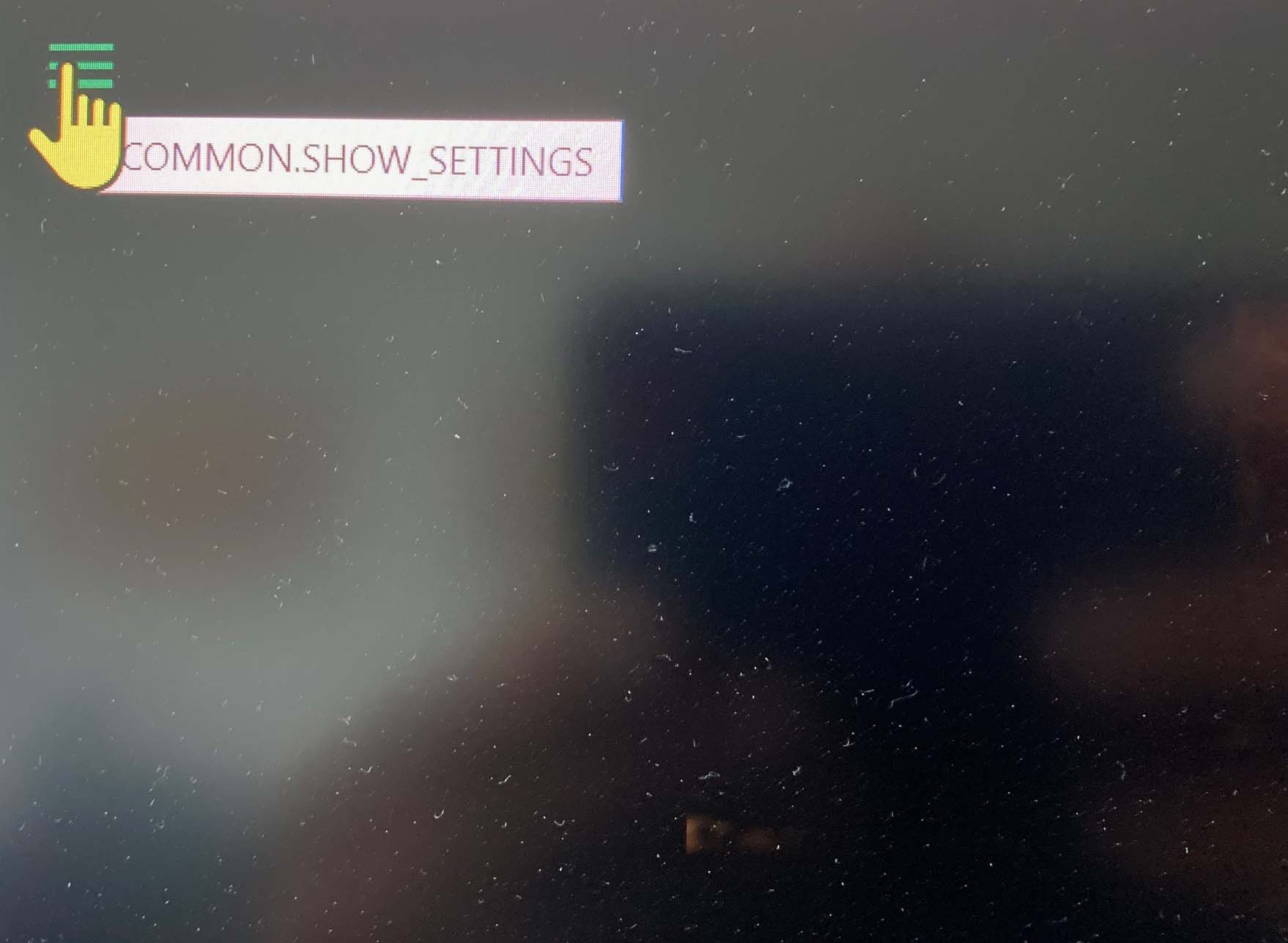

The mouseover does not show the correct prompt. Here is the log http://logs.volumio.org/volumio/CE00y17.html
