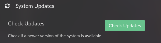

running 0.60 the OTA does not find the 0.61 (Test Mode is on).
Do I have to flash it manually? Or is there a trick how to use OTA?
Ah, I found it myself - Test Mode must be OFF ! ![]()

running the 0.60 OTA shows 0.61 as a newer version. I startet the update and it seems to be successful. But after the reboot version 0.60 is still active. What went wrong here?
Cheers,
Robert
Hey @Robert.Hecht,
Can you check the process again if 0.061 is still offered?
Can you share logs after OTA?
Can you remind me your hardware specs?
Same for me. I also tried with Test Mode off. No luck.
(Pi 3B+ with Allo DigiOne)

OTA updates are available starting from version 0.060 onward.
As already mentioned, Test Mode should only be enabled for plugin testing.
If you enable Test Mode for system updates, your device will point to the production Beta release channel instead of staying within the Alpha track.
I do have 0.060 (with test mode OFF) and I donāt see 0.061 as update via OTA.
Hey @Ema82,
Lets take this with methodical steps:
- change your device name in UI (required)
- change back to what it was (not required)
- reboot
- check if OTA is offered in System Settings
Of course, share logs.
I changed the device name and it worked. Thank you!
Hereās the log in case you need it for further analysis:
http://logs.volumio.org/volumio/evjHHxC.html
