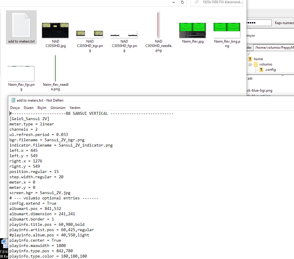

OK, before @2aCD comes back - I made a fix for Sansui 2V, added a skin with reverse indicators + 1 new
1920x1080 FIX.zip (2.0 MB)

Hello Gelo5, thank you for sharing, but sansui images are not available in the zip file. Can you check?
Sansui graphics were not improved. Only meters.txt.
ok sorry thanks

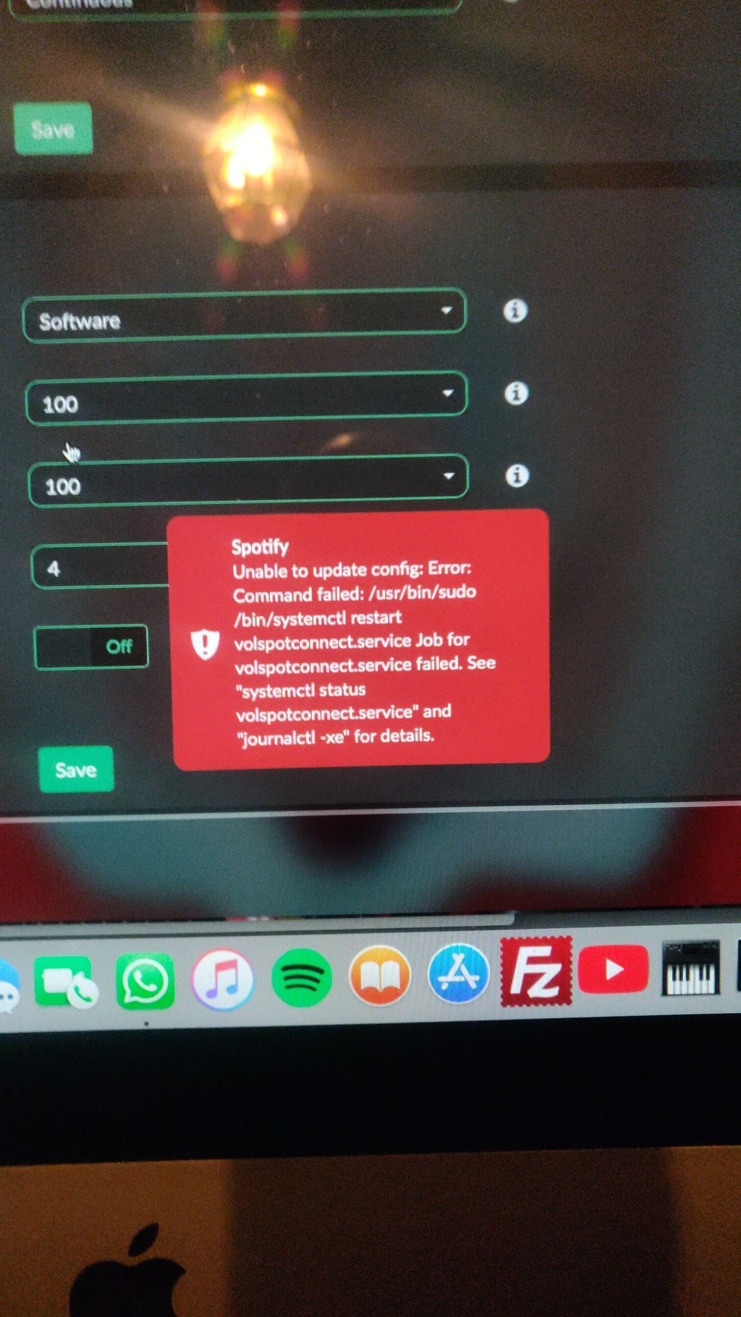

have a small problem with peppy meter.
i would like to have mixer type set to non when using spotify connect.
if peppy meter is off, spotify works on mixer type non, but as soon as i turn on peppy spotify doesn’t work anymore.
it works in both cases if mixer type is set to software and peppy meter is on.
can this be fixed somehow or am I asking too much?
ps, it worked once but after selecting another mixer it doesn’t work anymore. not even after a factory reset.

cheered too early, meters don’t move, spotify works.
in this setting it matches what it says.
when I change the mixer from non to software I get this error.
mixer type non
volumio@volumio-philips-1543-nos-dac:~$ systemctl status volspotconnect.service
● volspotconnect.service - Volspotconnect2 Daemon
   Loaded: loaded (/lib/systemd/system/volspotconnect.service; disabled; vendor preset: enabled)
   Active: active (running) since Fri 2022-12-23 17:17:56 UTC; 44ms ago
 Main PID: 3271 (bash)
    Tasks: 2 (limit: 4915)
   CGroup: /system.slice/volspotconnect.service
           ├─3271 /bin/bash /usr/lib/startconnect.sh
           └─3273 ./usr/bin/vollibrespot -c /tmp/volspotify.toml -
Dec 23 17:17:56 volumio-philips-1543-nos-dac systemd[1]: Started Volspotconnect2 Daemon.
Dec 23 17:17:56 volumio-philips-1543-nos-dac volumio[3271]: vollibrespot v0.2.5 8922128 2022-05-31 (librespot 08d8bcc 2020-10-07) -- Built On 2022-05-31
Dec 23 17:17:56 volumio-philips-1543-nos-dac volumio[3271]: Reading Config from "/tmp/volspotify.toml"
Dec 23 17:17:56 volumio-philips-1543-nos-dac volumio[3271]: [Vollibrespot] : Using Alsa backend with device: volumio
mixer on software, it only works again with off and on spotify plugin
   Active: failed (Result: start-limit-hit) since Fri 2022-12-23 17:17:56 UTC; 13s ago
  Process: 3283 ExecStart=/bin/bash /usr/lib/startconnect.sh (code=killed, signal=TERM)
 Main PID: 3283 (code=killed, signal=TERM)
Dec 23 17:17:56 volumio-philips-1543-nos-dac volumio[3283]: Reading Config from "/tmp/volspotify.toml"
Dec 23 17:17:56 volumio-philips-1543-nos-dac volumio[3283]: [Vollibrespot] : Using Alsa backend with device: volumio
Dec 23 17:17:56 volumio-philips-1543-nos-dac volumio[3283]: [Vollibrespot] : Failed to register IPv6 receiver: Os { code: 19, kind: Uncategorized, message: "No such device" }
Dec 23 17:17:56 volumio-philips-1543-nos-dac systemd[1]: Stopping Volspotconnect2 Daemon...
Dec 23 17:17:56 volumio-philips-1543-nos-dac systemd[1]: volspotconnect.service: Main process exited, code=killed, status=15/TERM
Dec 23 17:17:56 volumio-philips-1543-nos-dac systemd[1]: volspotconnect.service: Succeeded.
Dec 23 17:17:56 volumio-philips-1543-nos-dac systemd[1]: Stopped Volspotconnect2 Daemon.
Dec 23 17:17:56 volumio-philips-1543-nos-dac systemd[1]: volspotconnect.service: Start request repeated too quickly.
Dec 23 17:17:56 volumio-philips-1543-nos-dac systemd[1]: volspotconnect.service: Failed with result 'start-limit-hit'.
Dec 23 17:17:56 volumio-philips-1543-nos-dac systemd[1]: Failed to start Volspotconnect2 Daemon.
