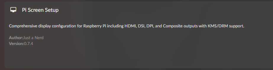

i tried the plugin beta but nothing, tried several solutions on internet by ssh comands but all failed, i’ve installed Pi screen setup and the display now is finally on witha Qr code on the left corner, but Touch displays plugin installation failed another time and i don’t want to make a fresh installation of Volumio…
