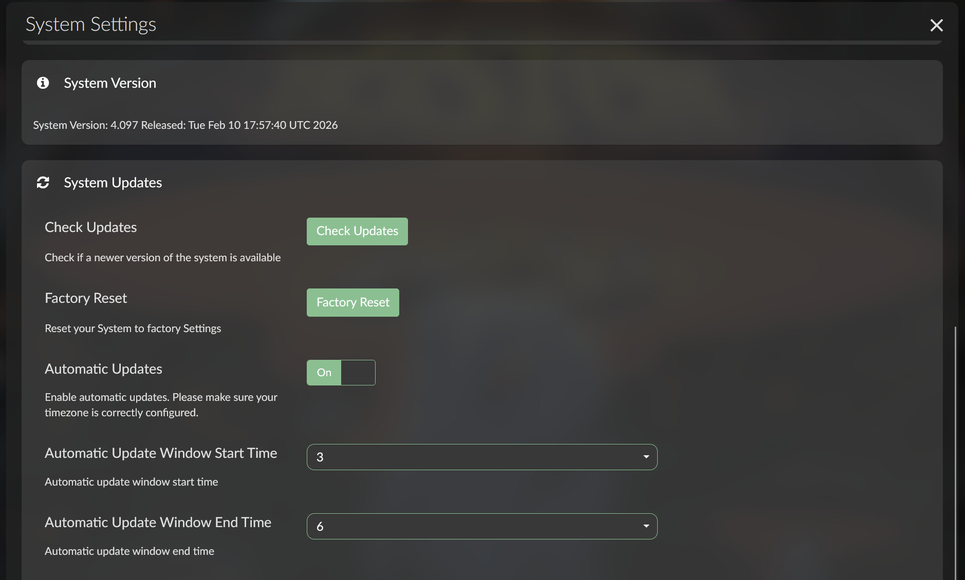

please try a factory reset even better if you move to Volumio4 with a fresh start
Thank you for your answer.
What do you call a factory reset ?
A fresh install ?
Under the system menu
Ok. Thank you.
