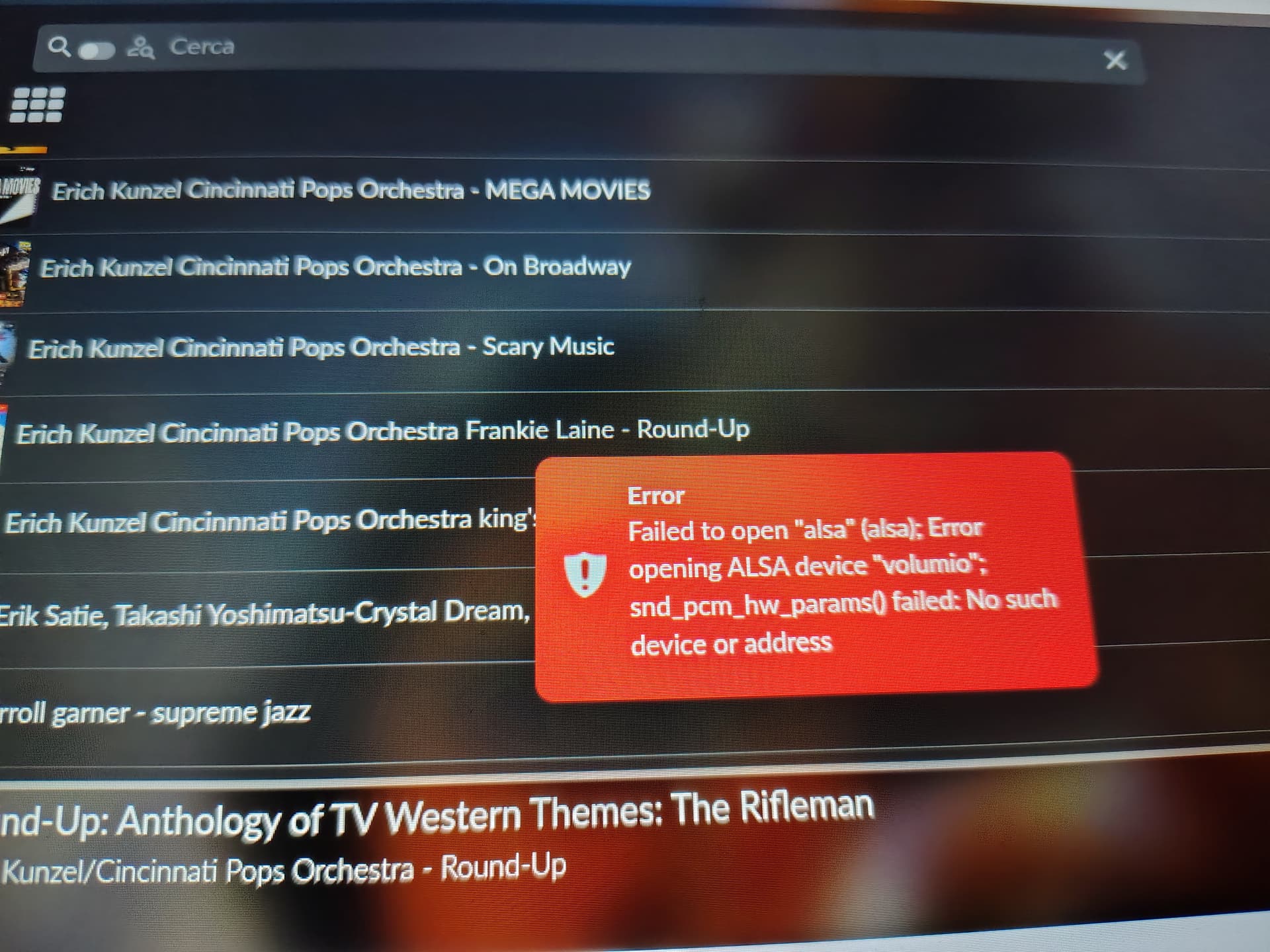

Every now and then when I change between tracks, even if they are of the same type, only flac or only dsd, this message appears.
