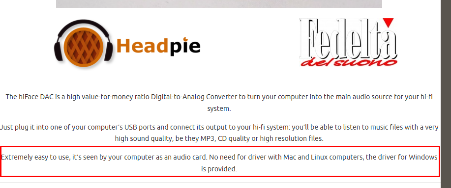

Normally for Linux you don’t need drivers, it should work out of the box as part of the kernel. However with Pro-ject I can understand that they don’t want this :slight_smile:

I still don’t get why you are going on about the hiface drivers. These are only needed for Windows, for Linux and Mac the kernel has a standard usb audio driver, which covers all supported/ registered usb audio devices. Afaik there is no other way to connect a USB DAC to linux.

You have a Pro-Ject Streambox Ultra and wish to connect it to an M2Tech HiFace DAC? And for some reason you believe you need HiFace drivers on linux (which do not exist anywhere), correct?

Believe me, linux does not need specific drivers to connect a USB DAC, there is a generic one for all of them.
