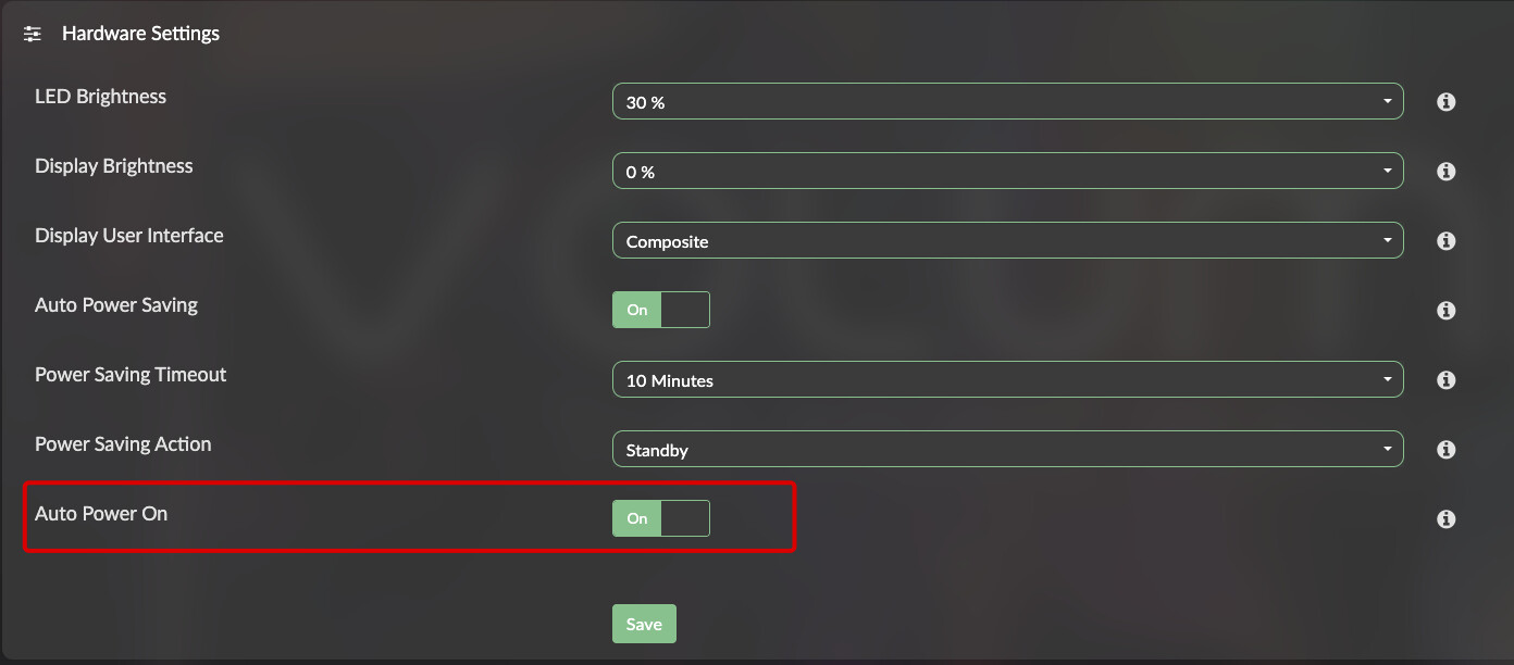

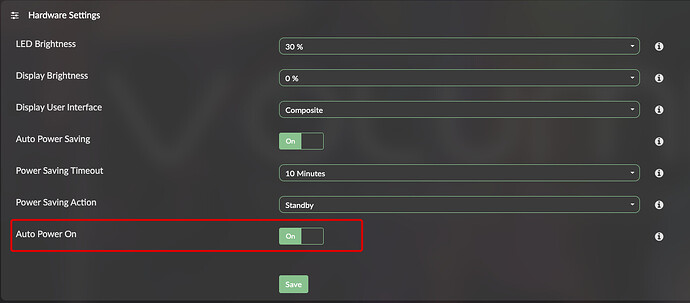

  • You have unstable netpower, where a voltage drop initiate a startup due to settings:
    You can try what happens when you turn it off.

Hi Wheaten,
the Auto Power On was off, but what I figured out was, that when I opened the Volumio App there was a track playing and I could not pause it. No matter if I pressed pause or restarted the app, it did not stop. I normally use Qobuz and Volumio I only used a few times in the beginning to check it out and look at the various settings for the Primo Plus.
There was a queue of songs there and I guess those just triggered the problem despite not having opened the Volumio app on any of these occasions.
