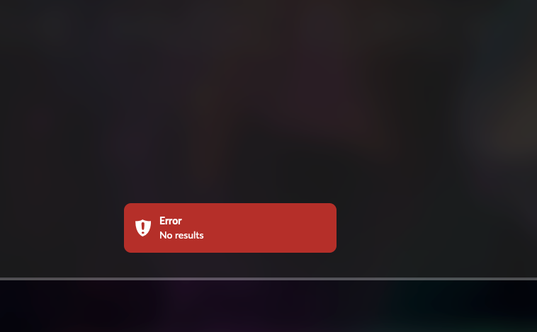

Hi @patrickkfkan, lately, I’ve been having problems with the plugin where it stops playing and then I need to restart the pi to get it to work again. Then after a while, it stops again. Today, I ran into a problem were I can’t get it to work not matter what I try, and I can’t get into the plugin settings. When I try going to the browse the youtube2 pluign, I get an error.
logs/bug report: http://logs.volumio.org/volumio/pML5nps.html
me too!!
He’s working on it.
Thank you~~
Resolved for now in v1.1.4, currently in beta channel of plugin store.
Thanks @patrickkfkan! It’s working again.

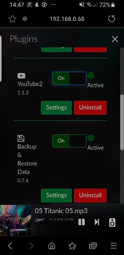

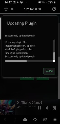

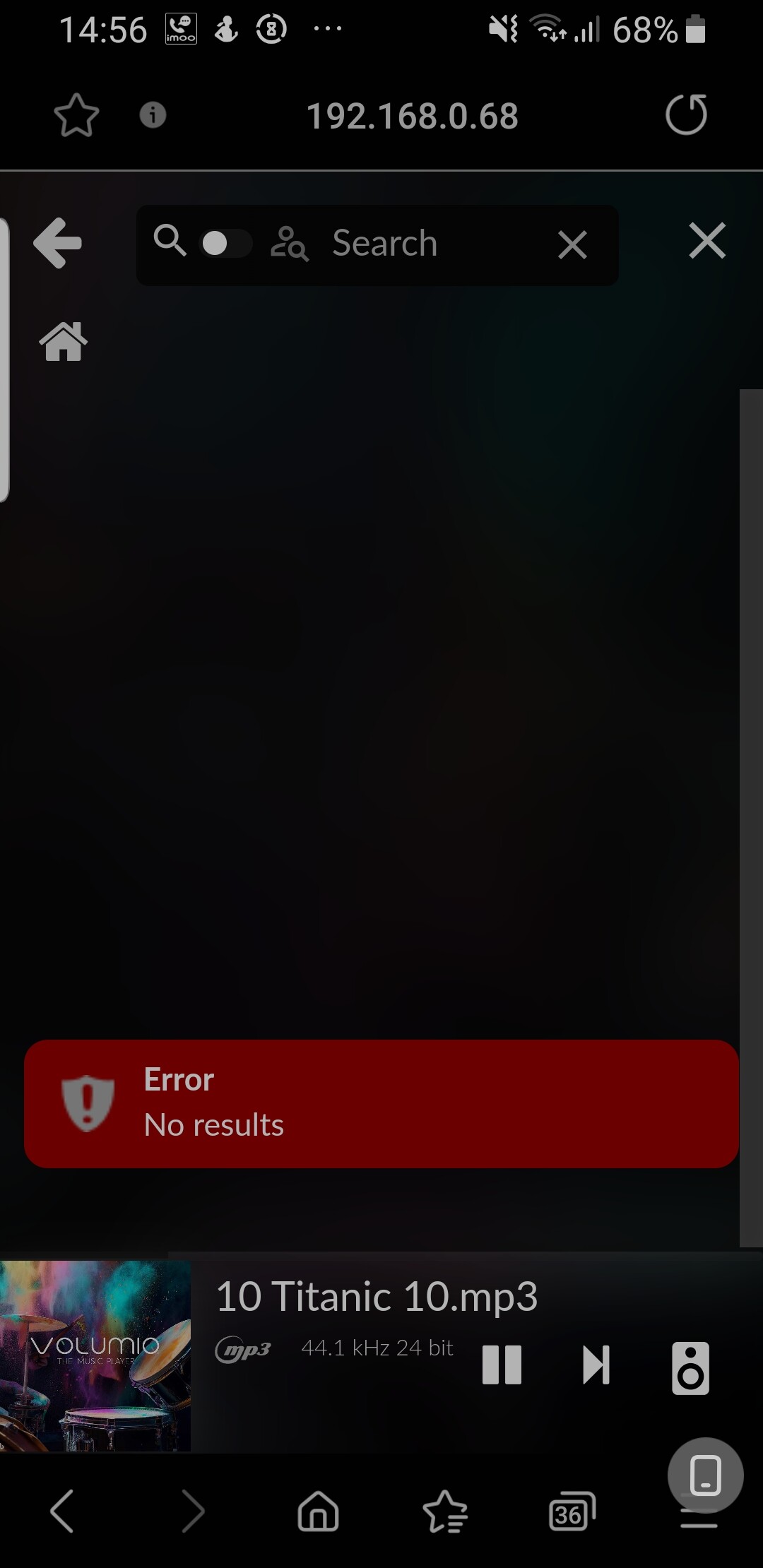

I updated to V1.1.4. It said “successfully installed”, but it still is V1.1.3.!?
And it still shows this error message:
You need to do it in this order, don’t forget the restart!
Unistall the plugin
Install the beta version
Restart Volumio
Authorise with YouTube
For information, the plugin is now released as stable.
So you should be able to update the version installed.
But a reboot is welcome ![]()
