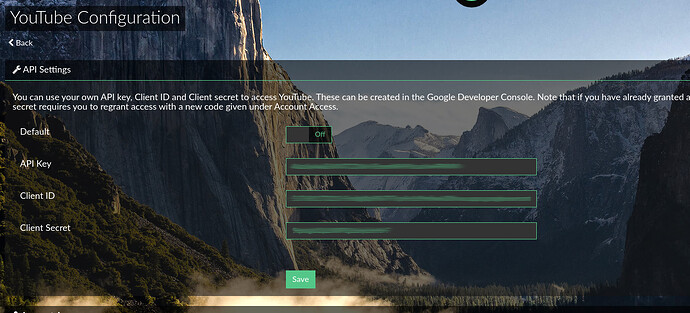

  1. Open Volumio web interface in your browser, go to Plugins->Installed Plugins and enable the YouTube plugin. Then click Settings.
  2. The default is to use the credentials provided by the official YouTube plugin. To change that:
    • Under API Settings, turn off the ‘Default’ switch.
  • In the corresponding fields that appear, enter the API key, Client ID and Client secret you created in your Google Developer Console.
  • Click Save.

No, you do not. Once you have created the credentials, you just have to enter them in the Plugin settings in the web browser.

oh silly me - now i checked it
the default button has to be switched off to get the required input fields
