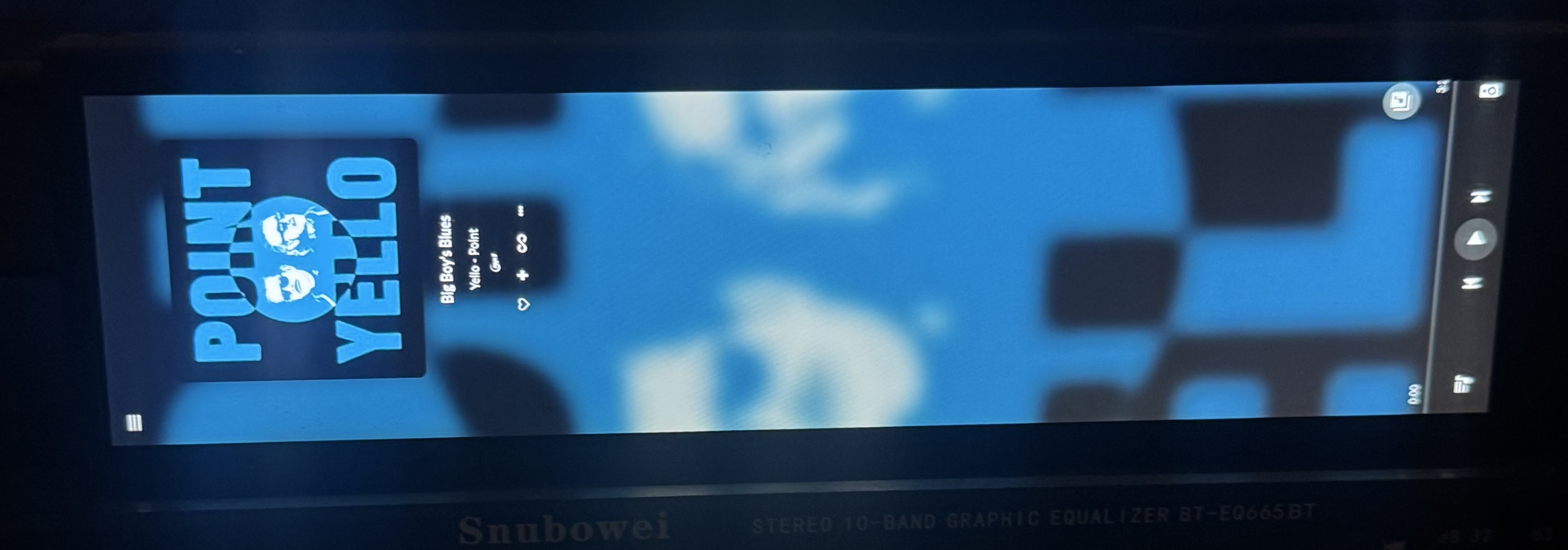

Not sure if you’re using a rpi3,4 or 5. add to /boot/userconfig.txt:
if rpi4:
dtoverlay=vc4-kms-v3d-pi4
hdmi_group=2
hdmi_mode=87
hdmi_timings=480 0 88 44 148 1920 0 4 5 36 0 0 0 60 0 89000000 7
hdmi_drive=1
framebuffer_width=1920
framebuffer_height=480
max_framebuffer_width=480
max_framebuffer_height=1920
if rpi5:
dtoverlay=vc4-kms-v3d-pi5
hdmi_group=2
hdmi_mode=87
hdmi_drive=1
I’m using rpi3
hdmi_group=2
hdmi_mode=87
hdmi_drive=1
Thank you very much, everything works with this code:
hdmi_group=2
hdmi_mode=87
hdmi_drive=1
We are very happy! But, only the screen does not rotate, it is standing vertically, and it is necessary horizontally. Commands were entered in userconfig like this: display_rotate=1; display_rotate=3; kmsdrm.rotate=1; kmsdrm.rotate=3. Can you please help with this question? Rpi3🫠

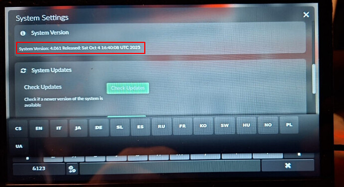

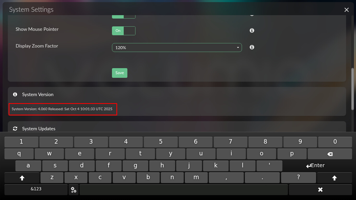

New install 4.028 Rapberry PI5 Virtual keyboard not work are possibility to fix it ?

Yes working on the x86, BW V4.060: :wink:
rPi5, BW V4.061:
