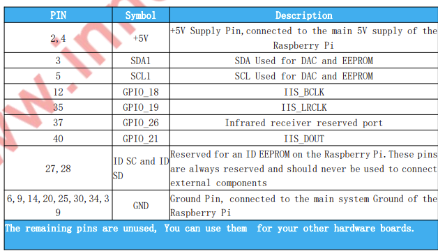

Hello everyone,
i am new and i have a RPI4b with Innomaker dac pro and 2 display. Both of them not work when i follow the user guide of them. Somebody can help me to connect 1 of them to my Pi?
I am pretty sure you have a issue with shared GPIO’s between your HAT and screen.
