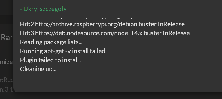

Yes. Install Volumio 3.611 and Touch Display 3.3.8.
Works. Thank you.
You need to reinstall Volumio and Touch Display 3.3.8.
No other way?

I did factory reset. Could succesfully install Touch Display.
