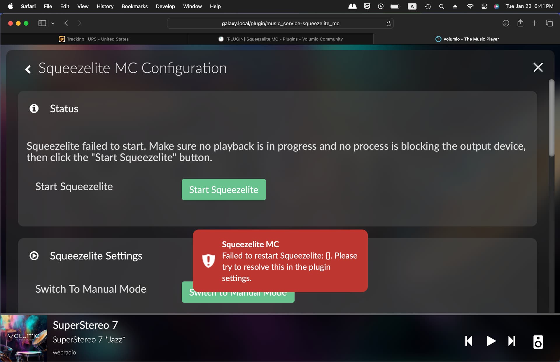

Thanks very much, I ran this:
volumio@galaxy:/data/plugins/music_service/squeezelite_mc$ sudo bash install.sh
[sudo] password for volumio:
Installing Squeezelite binary...
Squeezelite MC installed
plugininstallend
But the plugin still won’t start:
I also then restarted this unit just to see if that changed anything, but it did not.
