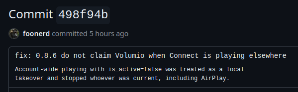

Hey @Sterke-Jerke,
Git head is 498f94b
Package json is 0.8.6 - proof here: alsa_soloist_connect/soloist_connect/package.json at 498f94bc1574c26514058e977c62831cfa98166e · foonerd/alsa_soloist_connect · GitHub
Yes, it is pushed.

commit 498f94b geschreven : 2026-09-11 11:19:46 UTC (13:19 NL)
repo pushed_at : 2026-09-11 16:23:51 UTC (18:23 NL)

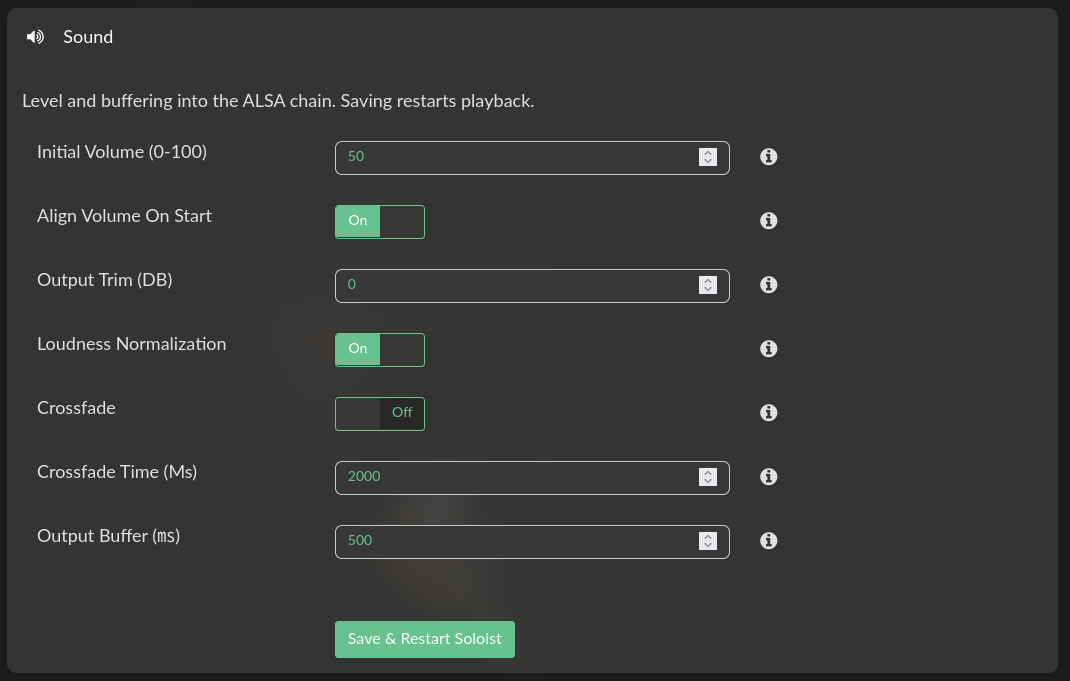

When playing the same track through Spotify Lossless and Qobuz on my RIVO+, Spotify is clearly several dB quieter. This seems to be caused by Spotify’s loudness normalization being enabled in Soloist.
I initially thought normalization could not be disabled in Soloist, but I found that Music Assistant already provides an option for this. Their implementation appears to use:
audio.normalize_v2=false
Reference:
Would it be possible to add a simple Loudness Normalization ON / OFF option to the Volumio Soloist Connect plugin as well?
What I would like is simply for OFF to disable Spotify’s own loudness normalization, so that Spotify plays at the original track level rather than being normalized.
I am currently leaving Output Trim at 0 dB, since a fixed gain adjustment cannot fully compensate for normalization when the amount of attenuation varies between tracks.
Thanks for all the work on the plugin.

You had the right cause. Spotify Lossless sitting quieter than the same track on Qobuz is Spotify’s own loudness matching, not Output Trim and not Align volume.
Soloist still has no official on/off for that. No CLI flag, no WebSocket command. Spotify’s own docs still say Soloist does not read a configuration file. What we can do is write the engine prefs key (audio.normalize_v2) under the data dir before Soloist starts. That is the same undocumented store Music Assistant already uses. It is Spotify’s key, not theirs, and it is not a published Soloist API.
That last part matters. If a later Soloist build ignores the line, or Spotify renames or drops it, the plugin switch will still be there and the file will still be written - and the level may not move. I will not pretend that is a contract. There is nothing we can do in the audio shim either: by the time we see the samples, Soloist has already done the matching.
0.8.7 is on GitHub only. Store stays 0.8.5. Under Sound there is now Loudness normalization. Default is on, which is what boxes do today. Off writes the key false and restarts Soloist. That is not a dB trim. If you already raised Output Trim to chase Qobuz, turn that back before you judge the switch.
I have not claimed this matches Qobuz. That listen is yours on the RIVO+. After Save & Restart the journal should show SoloistConnect: loudness_normalization=off. If the tracks stay quiet with that on the log, the binary is ignoring the prefs and there is nothing further on our side until Spotify gives us a real switch.
Crossfade is left alone.
Install from the opening post. Uninstall the store plugin first.
I will not push this to the plugin store until it is confirmed working. Until then it stays on the cutting-edge line.

Hi Nerd,
Thank you very much for implementing this so quickly.
I tested the new loudness normalization option on my RIVO+, and I was able to confirm that the underlying method does work.
At first, switching Loudness Normalization to OFF in the UI did not change the playback level. After checking the logs and prefs, I found that:
/data/soloist/soloist.env
still contained:
LOUDNESS_NORMALIZATION="true"
and Soloist was therefore starting with:
engine_prefs loudness=on
I then manually changed it to:
LOUDNESS_NORMALIZATION="false"
and restarted Soloist.
After that, the log showed:
engine_prefs loudness=off
and the user prefs contained:
After a full reboot of the RIVO+, playback returned to normal, and the Spotify volume now seems to match Qobuz very closely.
So the good news is that the normalization-off method itself appears to work correctly with the current Soloist build.
The only remaining issue seems to be that, on my system, the UI setting is not being persisted to soloist.env.
Thank you again for adding this feature so quickly. This is very useful for comparing Spotify Lossless with Qobuz and local playback, and I really appreciate the work you are putting into this plugin.
Hey @shinichi.nochise,
I am not sure why you need to do manual changes to env file at all. This is wired in UI already.
Please inspect your setup.
I checked again after using Save & Restart Soloist with Loudness Normalization set to Off. It is now being saved and applied correctly:
config.json → false
soloist.env → false
So at the moment the UI path is working correctly on my RIVO+. The earlier true state may have been a one-off or timing issue on my side.
Thanks again for the very quick implementation and support.
Good. That is the path: Sound, Loudness normalization Off, Save & Restart Soloist. You should not need to edit soloist.env or the prefs by hand.
On install the switch is on. That is the current Spotify behaviour, so existing boxes do not jump in level. After the plugin is up, anyone who wants the original track level turns it off. I do not see a reason to ship the default as off and make every new install louder.
If the community later wants that default flipped, say so. Until then it stays on, and Off is one save.
