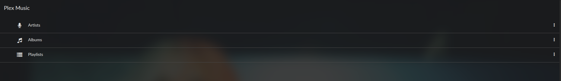

I created a music source plugin for Plex.
It pulls the audio files directly using the Plex API from the server.
Right now it just requires you to put in your plex token along with IP and port of your plex server. Plex token for the server is a little bit annoying to get but its one time thing.
Plugin added.
Currently only pulls the Artists, Albums and Playlists
It just uses the Plex UI for playback.
I know we can use DNLA to playback Plex but not playlists. I mainly wanted to have playlists because that is how I use it.
Let me know if this is useful for anyone and have any issues with it if you try it.
It pulls artists, albums and playlists

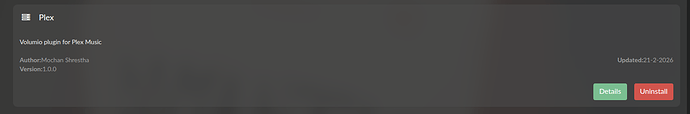

I have fixed the 1 and 7 as well by putting the dist folder and removing unneeded files.

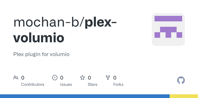

I have also created the pull request on the plugins.
Thank you @nerd @patrickkfkan and @Josh2000 for taking a look.
I use Plex because of a few unique features like Plexamp app, smart playlists and others.
It’s so nice now to be able to stream it in Volumio with this plugin.
The pull request has been merged and it is available in beta.
It is available in the beta plugins channel.
If you have any issues, please let me know.

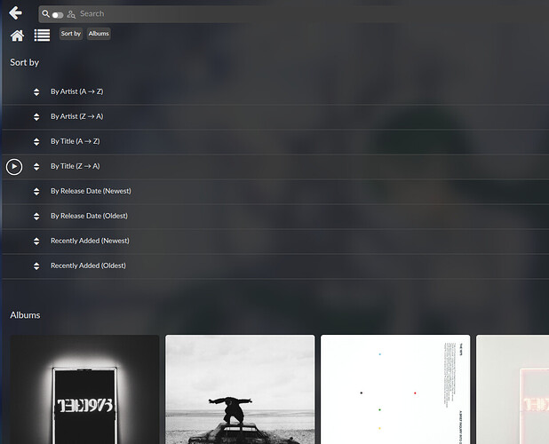

Hi mochan,
Really appreciate the plugin; it’s running flawlessly for me. One thing I’m wondering: is it possible to sort or display albums by Album Title or Composer rather than Artist? My classical library is huge, and with around 2,000 albums, the artist-based view becomes quite chaotic.
Thanks again for the excellent work.
Thank you Steve for trying out the plugin.

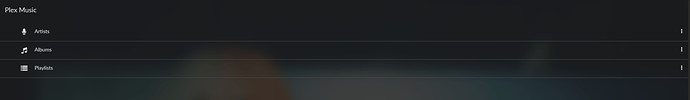

Also, thank you for the great idea. I added sorting criteria in albums here
The albums don’t have composer tag on plex. But, the title sorting should work.
I also added sorting for artists.
I used new entries on the list for sorting. I’m not sure if there is a better way to do this in volumio?
I’ll have more a new PR created probably next weekend when I have more of the stuff I’m working on put together. If you’d like to try it out now, you’ll have to build the plugin yourself or I’ll update once I’ve verified everything is good and starting working getting a PR merged.
Thanks, mochan, for all your continued work on this plugin. From your screenshot, it looks like album‑title sorting is working exactly as hoped. As an end user, though, my skills are pretty limited—I wouldn’t know where to begin with building a plugin myself. I’m in total admiration of people like you (and ā€œNERDā€) who can make this stuff happen. I’m more than happy to wait until the updated version appears in the plugin store.
Hi mochan,
I’ve just updated your Plex plugin to beta 1.1.0, and it’s working flawlessly for me. All my classical albums now sort and display alphabetically by album (composer) title exactly as I’d hoped.
It’s a fantastic plugin and a really impressive piece of work.
