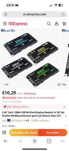

Is this article correct?
And can I use a dual display for the left and right volume bars without any other information about the audio file?
I would like to add them to my 3.5" HDMI LCD displayβ¦
Thanks.

The 2.42" I2C OLED looks fine, and that is a very good price for a larger screen. The SSD1309 controller should work fine with mpd_oled.
I meant to say, there are no options to configure mpd_oled to work in the way you want.
when it arrives I will try⦠I bought from AliExpress this morning

I have this exact screen with the SSD1309 controller and it works fine. ![]()
thank you!
