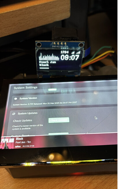

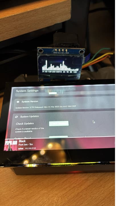

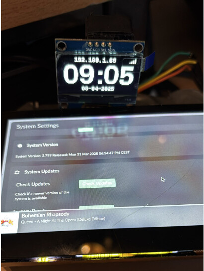

New software - new problems. Mpdoled does not show “spectrum”. Other information is shown. Tested on RPi4 and RPi5. System 3.799. My question: is it possible to set the display in the plugin:
1.spectrum only
2.standard as current
3.time and data only (no spectrum)?
Regards
Grzegorz

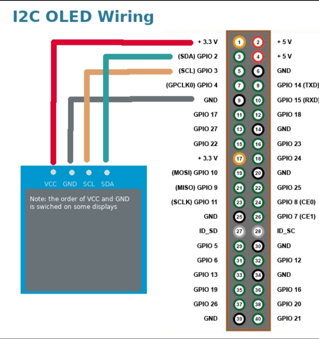

I’ll ask one more thing: does the VCC and GND power supply have to be from the Raspberry? Can it be powered separately from a power supply?

I have worked on the MPD_OLED dev branch to make this working. Meaning you need to program/build it manually and configure everything from the shell. However it’s not working anymore on the updated versions of Volumio. Due to lack of time I haven’t dig into it anymore.
Screenshots:
Modified source files:
You don’t need to power it from the rPi, but I would advise against a separate power supply.

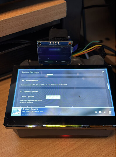

The basic does work, however the service doesn’t properly initiate, need to manually stop and start it after boot in order for alsa pipe picks it up. It’s all trial and error.
Status is used to set the display by rotary switch of push button.
Status=0:
Status=1:
Status=2:
Status=3:
The original plugin works the same way :sleepy:
@Gelo5 Remove the plugin and try using the non plugin approach. The code is available for you to change too.
Not sure that will help.
Having the same issue with the manual (dev) install.
The service will start mpd_oled, but it won’t react to the state of volumio.
If I stop the service and run from the shell it works, so really confused why. as the service has the same command.:
